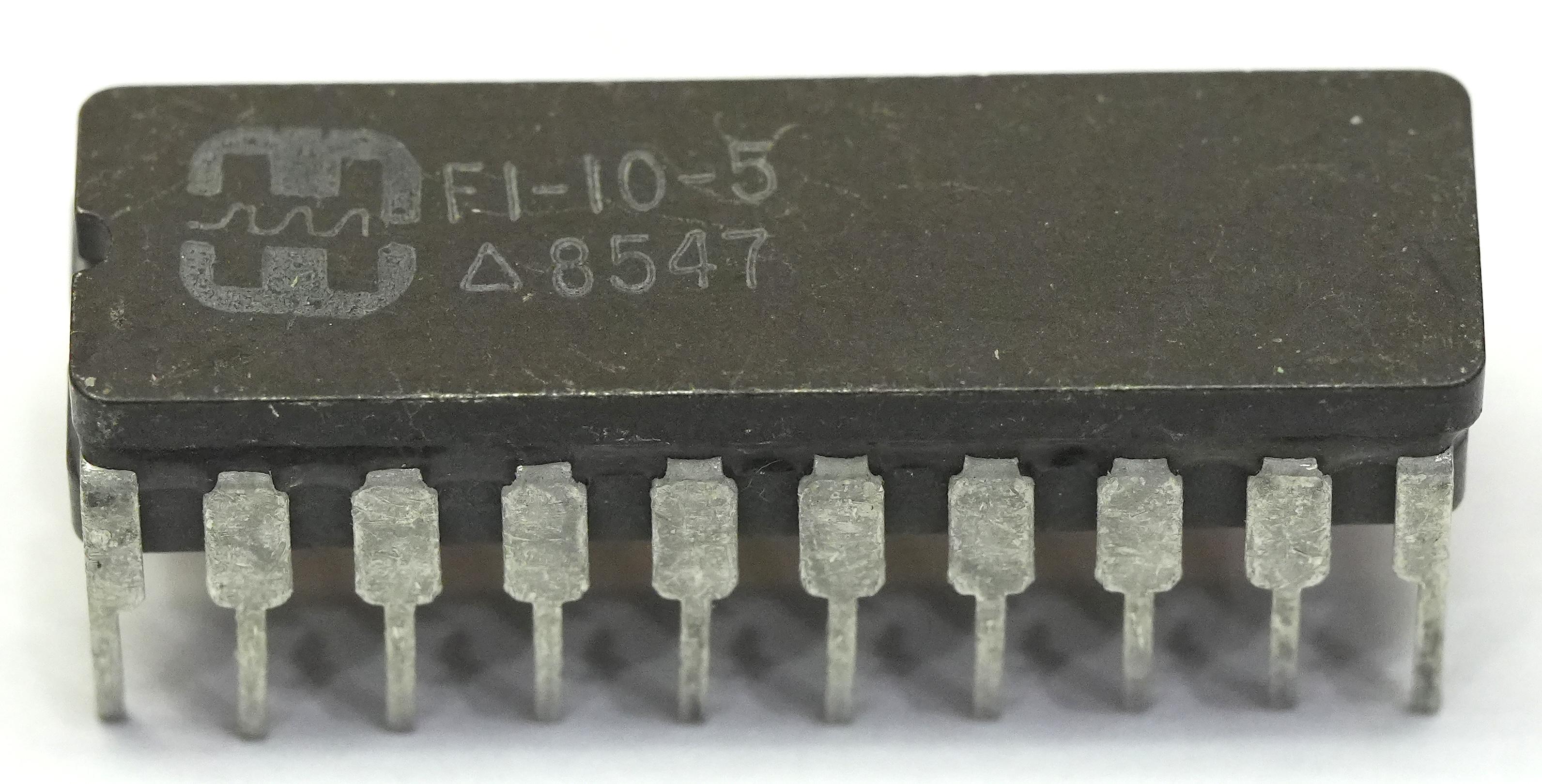

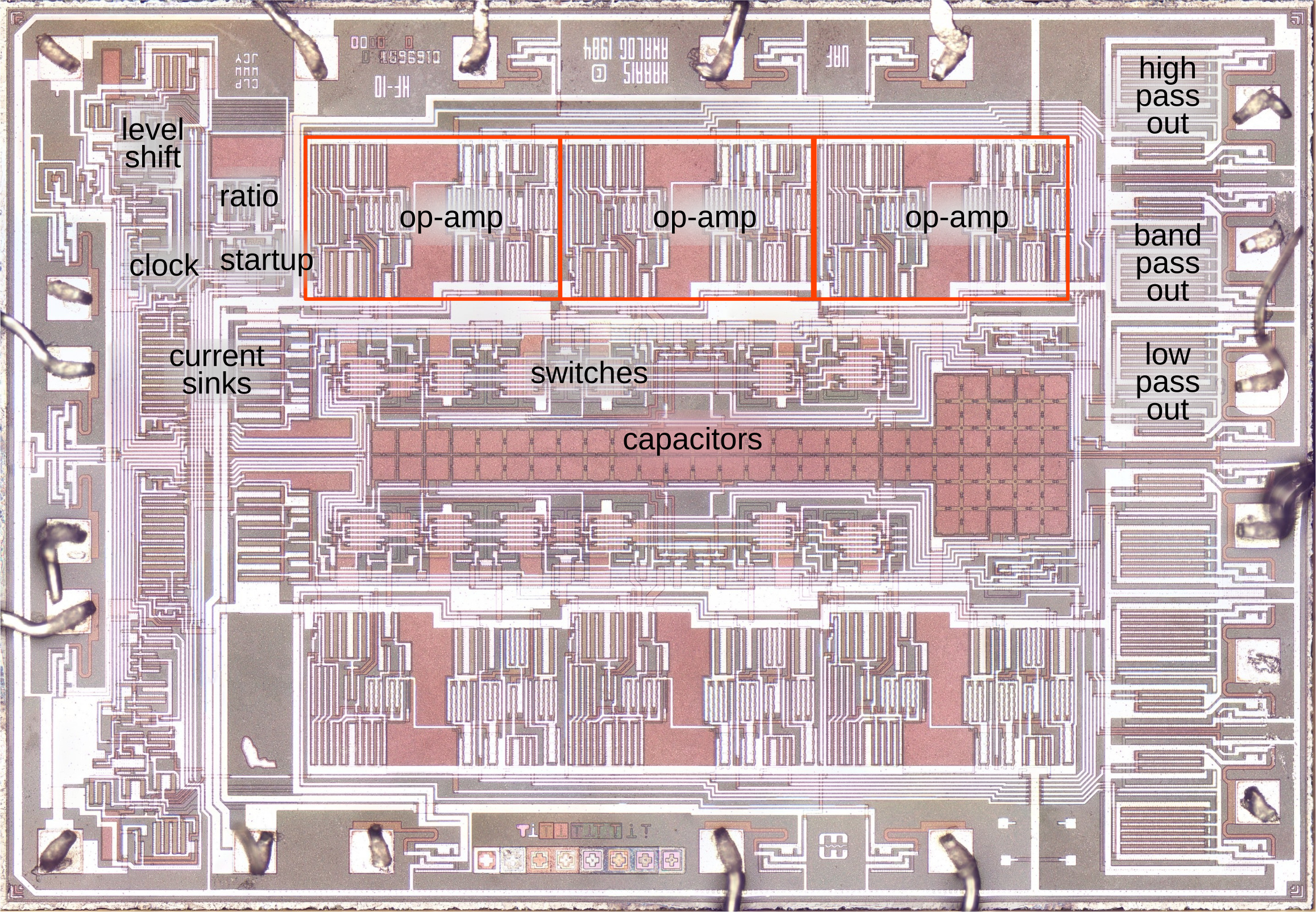

Sometimes it's easier to identify an IC with a microscope. While sorting a box of old ICs, CuriousMarc came across some Harris ICs labeled "F1-10-5", a mysterious part number that didn't show up in any databooks. Since unidentifiable ICs are useless, he gave me one to analyze. Conveniently, it was in a ceramic package, so I could open it up with a quick tap from a chisel. Under the microscope, the chip's most striking feature was a grid of square capacitors. With all those capacitors, I guessed that it was a switched-capacitor filter. The die provided another clue: the part number HF-10. With this information, we quickly found that the chip was Harris's version of the standard MF10 switched-capacitor filter chip.1
The Harris integrated circuit, labeled F1-10-5 (or maybe FI-10-5), with a 1985 date code. Photo courtesy of CuriousMarc.
Switched-capacitor filters were a popular way to implement analog filters in the 1980s. Rapidly switching capacitors in and out of a circuit enabled the construction of single-chip filters that were easy to use and performed well. The MF10, introduced by National Semiconductor in 1981, provides two flexible filters on a chip; each filter acts as a low-pass filter, band-pass filter, or a high-pass filter. The filter's characteristics are simple to control with a few external resistors.

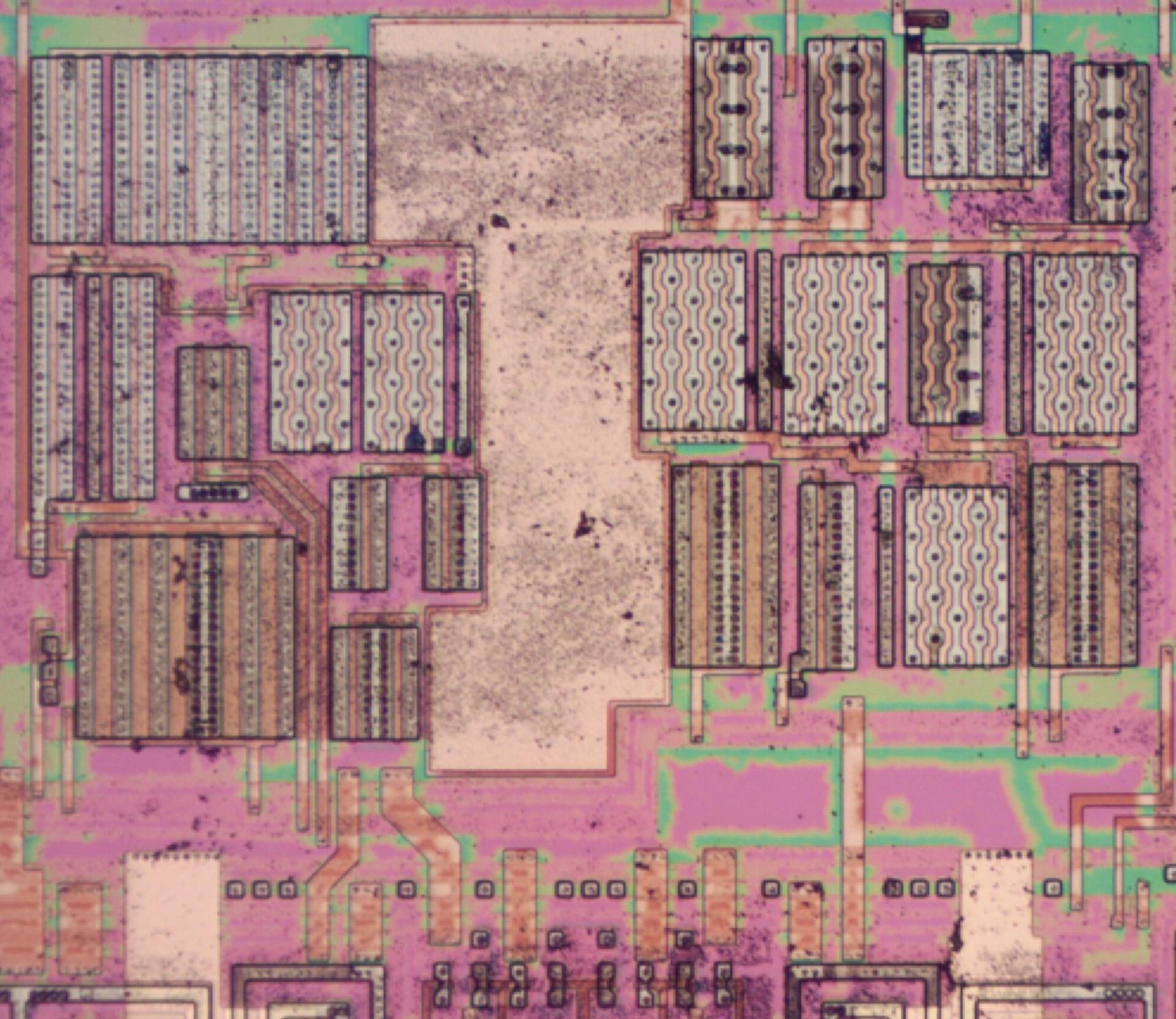

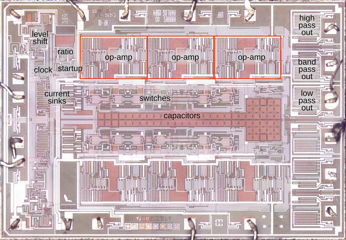

The Harris HF-10 die under the microscope with the main functional blocks labeled. (Click for a larger image.)
Since I had the chip under the microscope, I took the opportunity to analyze it more closely. The white lines are the metal wiring that connects the chip's circuitry. Under the metal layer are two layers of polysilicon (reddish) and the underlying silicon (gray). The top and bottom halves of the chip are mostly mirror images, corresponding to the chip's two filters. The distinctive reddish squares in the middle of the chip are 72 tiny capacitors, constructed from polysilicon. Above the capacitors, CMOS switches turn on and off at the clock frequency, switching capacitors in and out of the circuit. Each filter uses three operational amplifiers (op amps), outlined in red. At the right are the three outputs from the three op amps: high pass, band pass, and low pass. The control circuitry is on the left: clock level shifting, clock shaping, frequency ratio handling, startup circuitry, and current sinks to provide fixed currents to other parts of the chip. Around the edges of the silicon die, 20 hair-thin bond wires connect the die to its 20 external pins.

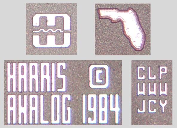

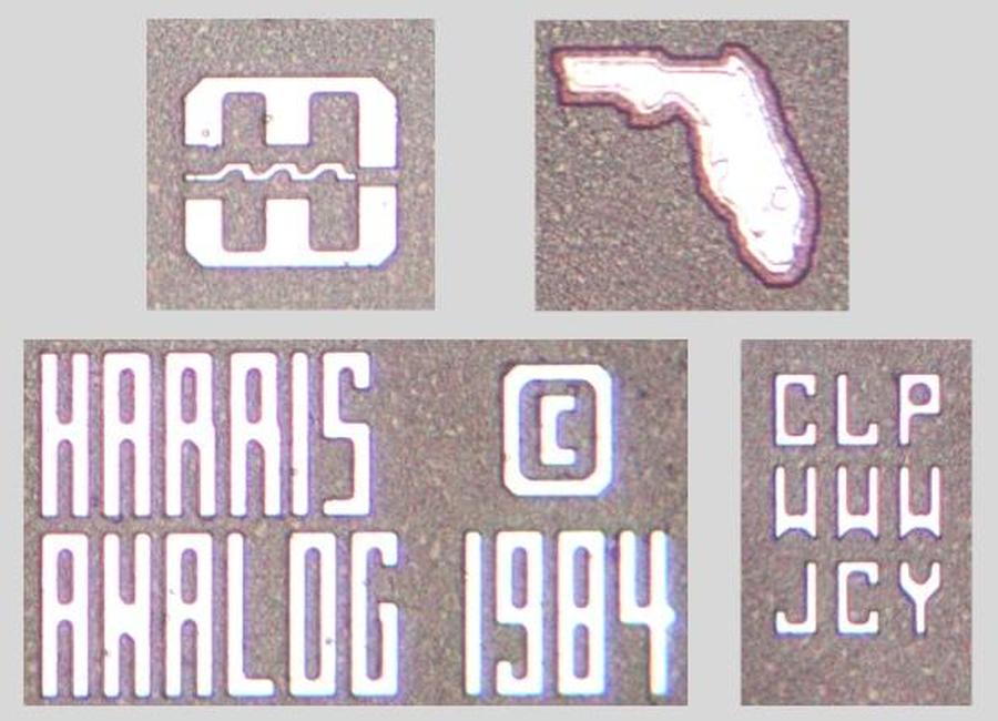

The die has some interesting chip art: a Harris logo and an outline of Florida; Harris was headquartered in Melbourne, Florida. The initials on the die are presumably the engineers who designed the chip.
Some interesting images from the die.

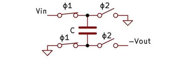

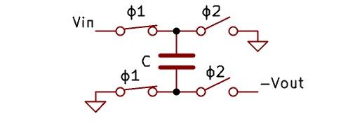

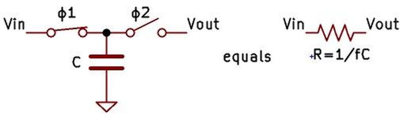

The filter is based on switched-capacitor circuits. A switched capacitor can replace a resistor in certain circuits, as shown below. The switches are controlled by a clock signal; the switches alternately close in clock phase 1 and phase 2 (ϕ1 and ϕ2). In phase 1, the capacitor is charged to the input voltage. In phase 2, the capacitor passes charge to the output. By rapidly toggling the switches, charge is (almost) steadily passed to the output. The larger the capacitance, the more charge that is passed through. Likewise, a higher frequency passes more charge. It can be shown that the circuit matches a resistor with resistance of 1/(fC): a higher capacitance and frequency correspond to lower resistance.
A switched capacitor can replace a resistor.

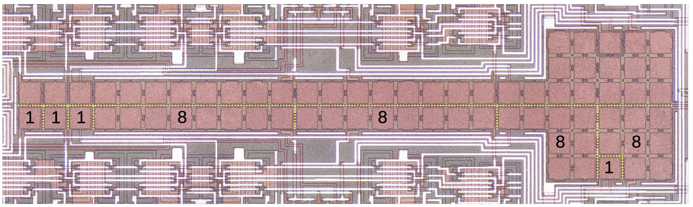

Why would you replace a simple resistor with this complicated switching circuit? In an integrated circuit, resistors are inaccurate and inconveniently large, especially high-value resistors. Replacing a large resistor with a small capacitor saves space on the die. Moreover, it is easy to generate an extremely accurate clock frequency with an inexpensive quartz crystal, making the filter's frequency highly accurate. Finally, the equivalent resistance can be changed simply by changing the clock frequency, making it easy to tune or sweep the filter.
On-chip capacitors are fairly inaccurate, with the capacitance typically varying by 20% from chip to chip due to variations in manufacturing conditions. However, this isn't a problem in the MF10 because the circuitry was designed to depend on the ratio between capacitances, which is stable. Specifically, the MF10 uses 72 identical square capacitors, which will have almost identical capacitances. Careful examination shows that some of the capacitors are separate, while others are connected in groups of 8 to form larger capacitors.2 This yields a highly accurate ratio of 8:1 between the grouped capacitors and the individual capacitors, even though the absolute capacitance will vary from chip to chip. Each capacitor is constructed from two layers of polysilicon,3 forming the plates of the capacitor, separated by a thin layer of insulating oxide that acts as the dielectric. I estimate that each capacitor square is 5 picofarads.
The grid of capacitors in the MF10. I've added yellow lines to show how the capacitors are grouped. The switches are above and below the capacitors.
This chip uses one more trick with switched capacitors: it inverts the voltage while acting as a resistor. In the switched-capacitor circuit below, there are four switches. The capacitor charges to the input voltage during phase 1, the same as before. But during phase 2, note that the top plate of the capacitor is grounded, while the output comes from the bottom plate. If the capacitor was charged to, say, 1 volt, the top plate is 1 volt above the bottom plate. So if the top plate is grounded, then the bottom plate must be at -1 V. (This is the same idea as a charge pump.) This circuit turns out to yield a more accurate filter because some parasitic capacitances cancel out.
By using four switches, the switched capacitor can invert the voltage.

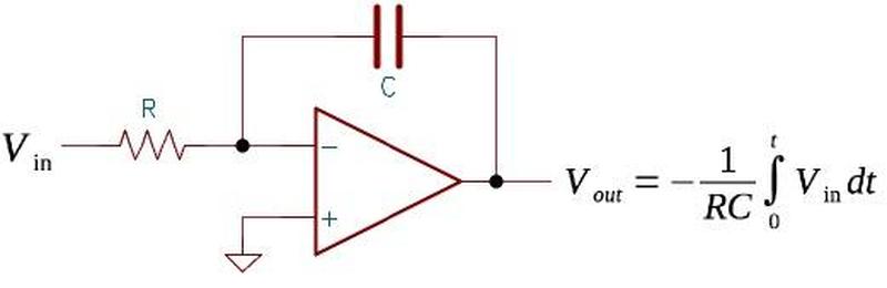

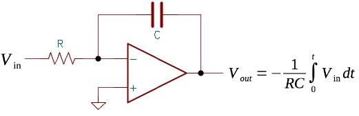

The op-amp integrator
The heart of most analog circuits is the operational amplifier, or op-amp. An op-amp takes two inputs and amplifies the difference by many orders of magnitude. Normally, an op-amp is configured with negative feedback, which forces the two inputs to be essentially the same. Op-amps are useful not only for amplification, but for filtering, buffering, summing, and other tasks.
A basic op-amp integrator.
The filter chip uses op-amps as integrators, to integrate an input voltage over time. The circuit above shows a simple op-amp integrator. The input voltage produces a current that flows through the resistor and charges the capacitor, so the capacitor holds the integral of the input voltage over time. You might expect that the left side of the capacitor would become positive as it charges. However, the op-amp's feedback forces both inputs to ground, so instead the right side of the capacitor becomes negative. Thus, the output is the negative integral.4
The MF10 chip uses the circuit above, except the resistor is replaced with a switched capacitor. The capacitor across the op-amp is not switched, but consists of either 8 or 16 capacitors from the capacitor grid.

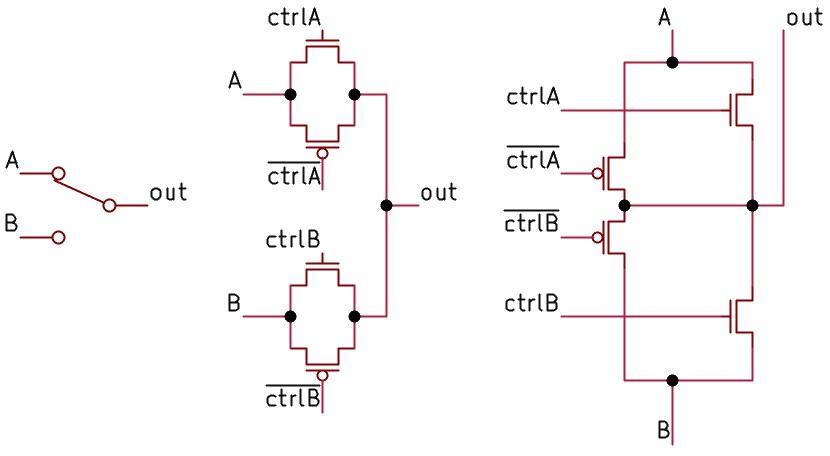

The CMOS switches

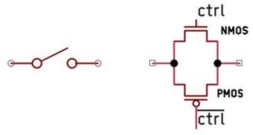

The CMOS switch is the technology that makes the switched-capacitor filter possible. A CMOS switch has a fairly low resistance (maybe tens of ohms) when closed and an enormously high resistance (hundreds of megohms) when open. This high resistance ensures that the charge doesn't leak out of the capacitors.
A CMOS switch is constructed by combining an NMOS transistor and a PMOS transistor. The NMOS transistor and PMOS transistor are opposites. An NMOS transistor is good at pulling the output low, while a PMOS transistor is good at pulling the output high, so in combination they provide an effective switch. An NMOS transistor is turned on by a high voltage on the gate, while a PMOS transistor is turned on by a low voltage on the gate. Thus, a CMOS switch requires two control signals of opposite polarity, which is a minor inconvenience.
A CMOS switch.
A CMOS switch.
The diagram above shows how a switch is implemented with an NMOS transistor and a PMOS transistor in parallel. When the control line is high, and the inverted control line is low, both transistors turn on, providing a path through the switch circuit. When the control line is low (and the inverted line high), the transistors turn off, opening the switch.

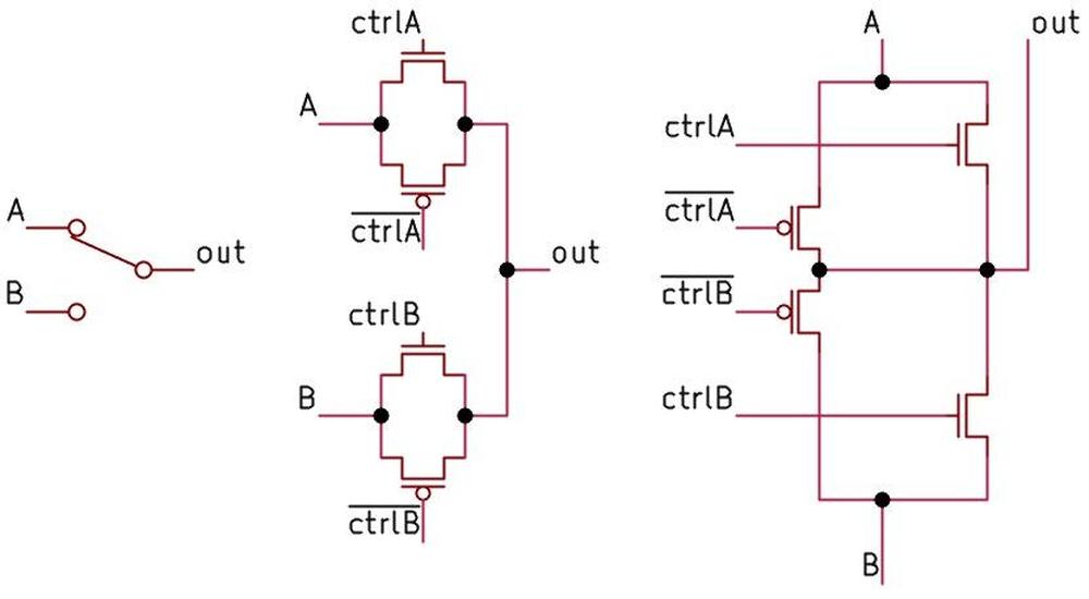

The chip uses CMOS switches in pairs, with one switch on and the other off. This forms the equivalent of a toggle switch that connects either A or B to the output. This circuit is simply two CMOS switches, with separate control lines for each switch, as shown below. In the MF10, the switch toggles at the clock frequency. During one clock phase, the switch is connected to A, while the switch is connected to B during the other clock phase. The schematic on the right, below, is the same circuit, but reorganized to match the layout on the die.
A double-throw CMOS switch.

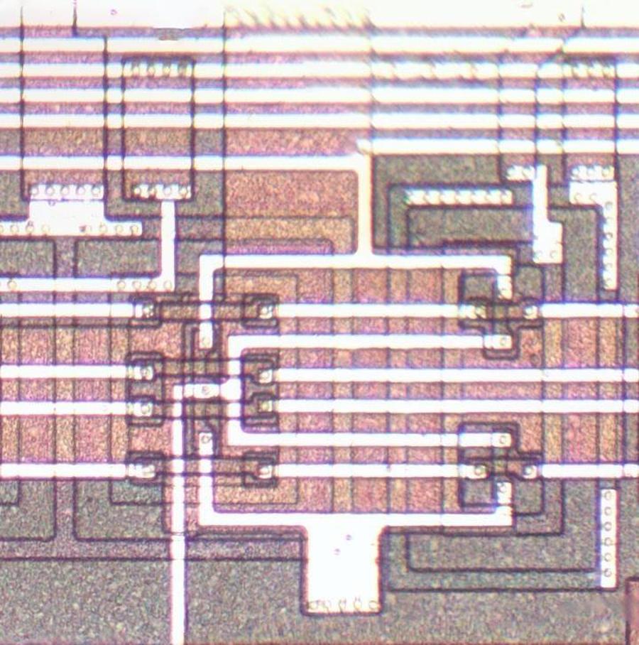

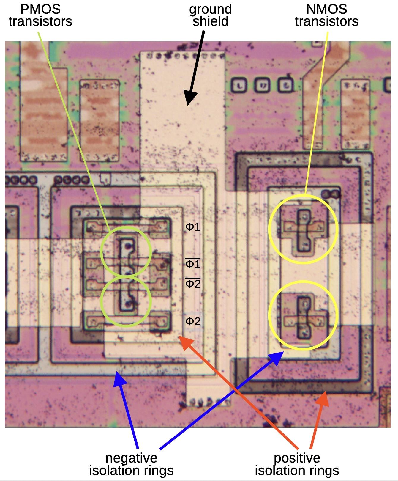

The photo below shows a CMOS switch on the die, constructed from two PMOS transistors and two NMOS transistors. The four control lines run horizontally in polysilicon, forming a transistor gate where they cross doped silicon. The upper PMOS and NMOS transistors are driven by the clock phase 1 (Φ1) signals, while the lower transistors are driven by the phase 2 signals.
CMOS switches on the die. The metal layer was removed to show the transistors.
One problem with switched-capacitor filters is that the clock can generate switching noise that appears in the chip's outputs. The MF10 uses several techniques to reduce clock noise. Each set of transistors is surrounded by two isolation rings: one positive and one negative. These block noise from traveling through the silicon substrate. Note that the rings have opposite polarity for the NMOS transistors and the PMOS transistors. The light tan region in the photo above is a second layer of polysilicon. This polysilicon is connected to ground, providing a shield layer over the switching circuits.
For the photo above, I removed the metal layer with acid5 to make the transistors more visible. The photo below shows the original die, with the metal layer connecting the transistors. The small black circles are connections between the metal layer and silicon or polysilicon.
The same CMOS switches, showing the metal layer.

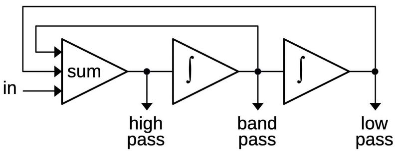

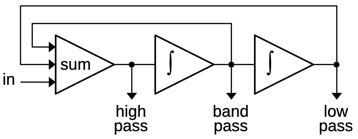

Putting it together: the state variable filter
There are many ways of creating a filter. The MF10 chip uses a technique called the state variable filter, invented in 1967. This circuit acts as three filters, with high-pass, band-pass, and low-pass outputs. Moreover, the circuit is flexible since the frequency, the gain, and the filter quality (Q) can be varied independently. It uses three op-amps: one to sum signals and two for integration. By changing how the values are summed, the characteristics of the filters can be changed. The diagram below shows a simplified representation of a state variable filter. The mathematics behind a state variable filter is complicated, so I won't get into it. In short, the signal, the integral, and the double integral form the three state variables that define the state of the system.
Simplified diagram of a state variable filter, with two integrators. Inspired by North Coast Synthesis.

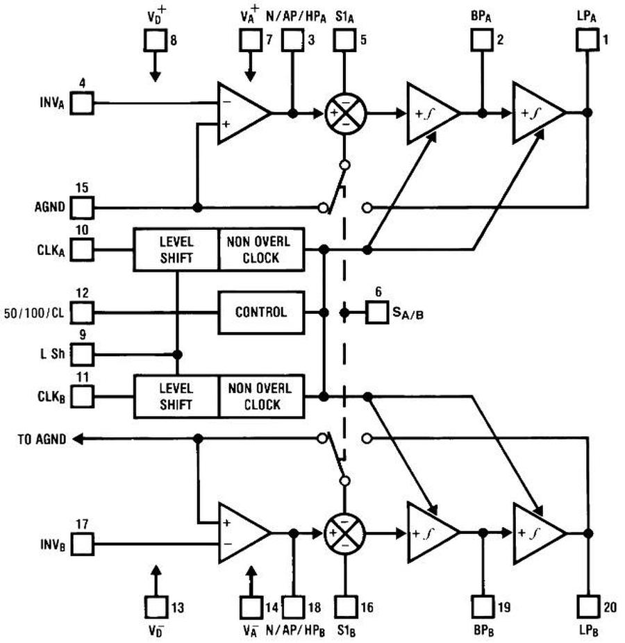

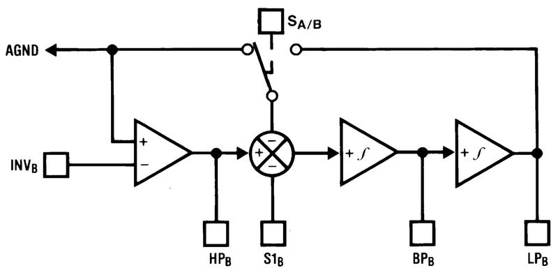

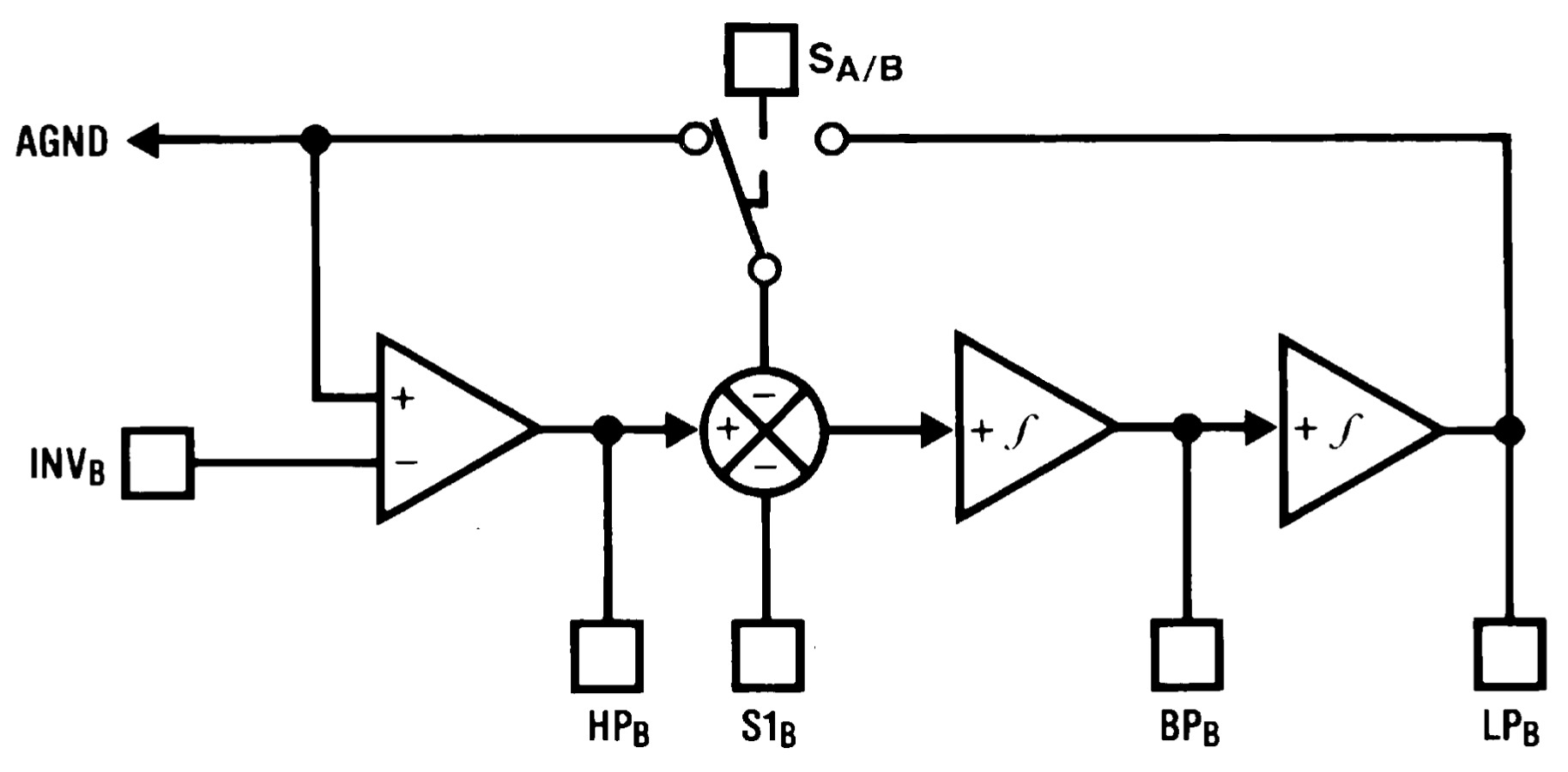

The block diagram below shows how the filter is represented in the MF10 datasheet.6 The diagram is similar to the diagram above, with three op-amps. However, the summing circuitry has been separated out. Moreover, the feedback paths are not shown explictly. Instead, resistors are connected between the chip's external pins (squares) to configure the filter as desired. The mode switch at the top allows the low-pass feedback to be controlled by an external pin (SA/B).
Block diagram of one of the filter sections. Adapted from the datasheet.

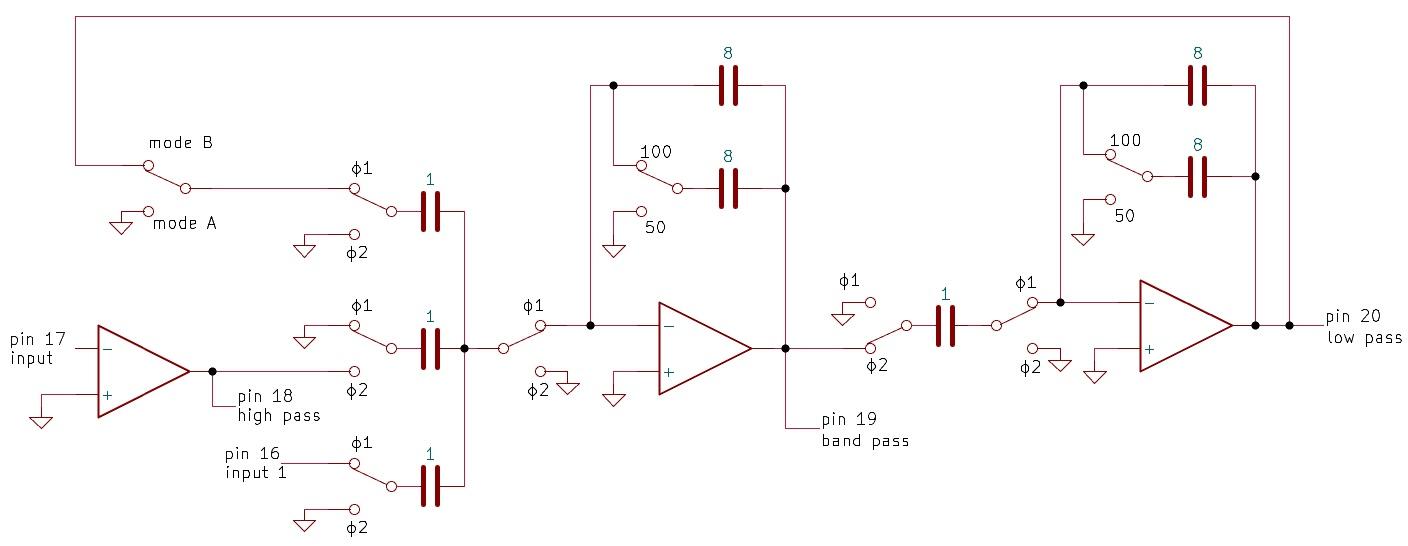

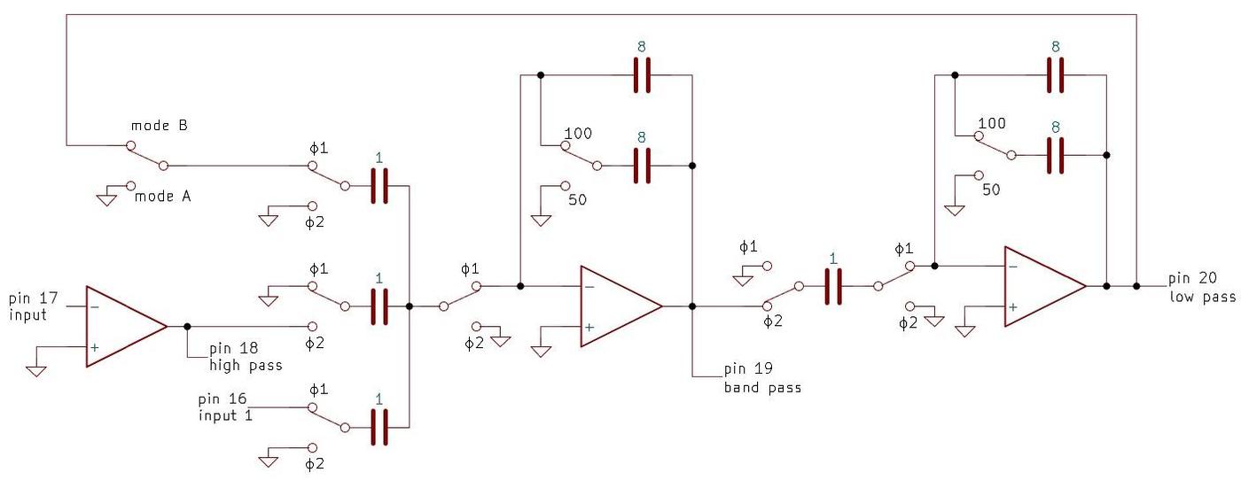

The schematic below is my reverse-engineered schematic of the filter, as implemented on the chip. It closely matches the block diagram, but fills in the details. In the block diagram, the summing circuit (circle) adds one signal and subtracts two signals. This summing circuit is implemented with the three switched capacitors on the left, which act as summing resistors. Note that one switch is grounded during phase 1, while the others are grounded during phase 2; switching the polarity implements addition versus subtraction. The top sum input is either feedback from the low-pass output or ground, selected by an input pin. A CMOS switch is used here, but the switch is static, not clocked, so it doesn't use protection rings and shielding like the other switches.
My reverse-engineered schematic of one of the filters. Click this image (or any other) for a larger version.
The integrators have switched capacitors on the inputs, acting as resistors. The integration capacitor is either 8 or 16 "squares" of capacitance, selected by a ratio selection pin. This controls the ratio between the clock frequency and the filter frequency, either 50:1 or 100:1.7 Although the integration capacitors are attached to a CMOS switch, the switch is static, so the capacitors act as regular capacitors, not switched capacitors.

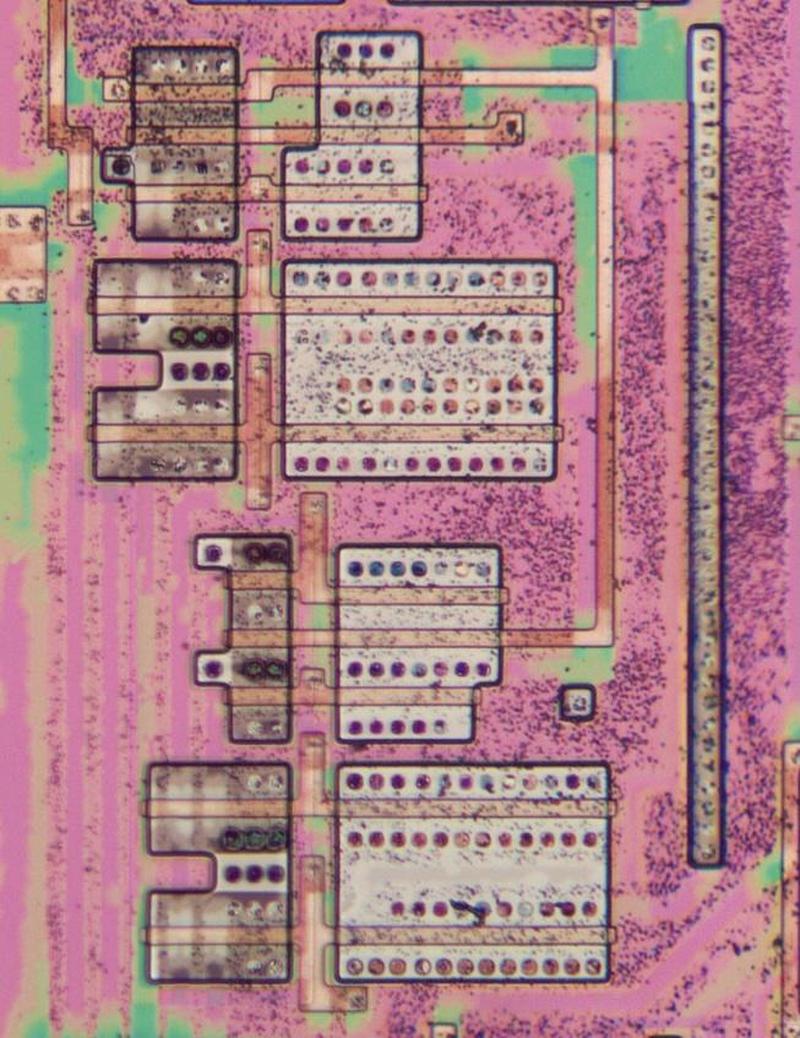

The op-amps
The op-amps are fairly standard CMOS op-amps, built from about 35 transistors. (You might get a lower count if you try counting the transistors below, since some of the blocks are multiple transistors.) The op-amp transistors are much larger than the CMOS switch transistors (very bottom, center). On the die, each op-amp is split into two parts: the differential amplifier on the left and an additional amplification stage on the right. A large capacitor (pinkish) sits between the halves. My first thought was that this was the integration capacitor, but it is just a frequency compensation capacitor, common in many op-amps to stabilize the output. The op-amps also have large transistors next to the output pins; these transistors are functionally part of the op-amps, but located next to the pins to minimize resistance.
One of the chip's op-amps. I removed the metal layer to make the transistors visible.

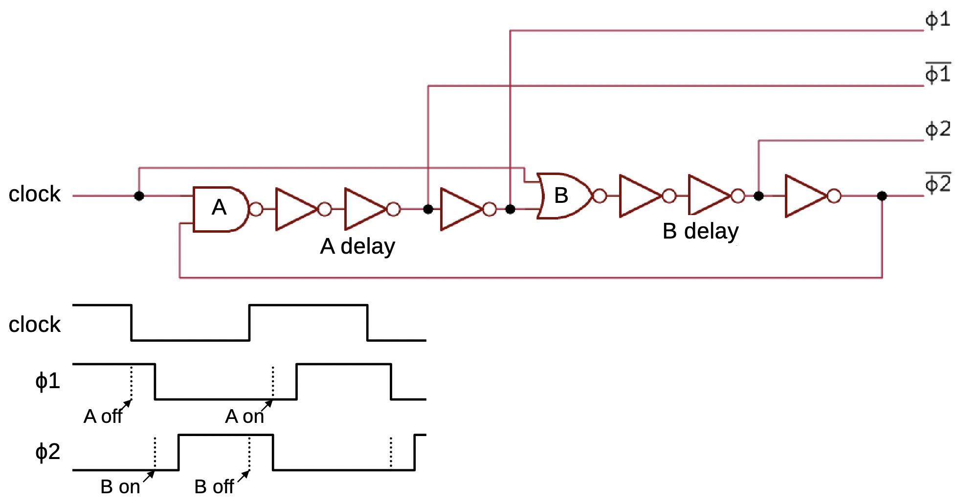

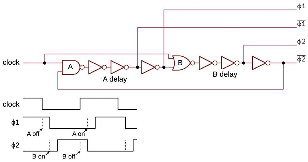

The non-overlapping clock generator
The MF10 chip is driven by external clock signals, one for each filter, with the frequency of the filter proportional to the clock frequency. The photo of the CMOS switches earlier showed that the clock drives four control lines for the switches. You might think that two control lines would be sufficient: the clock and the inverted clock. The problem is that it is very important to avoid having both switches closed at the same time, even for a moment, as that will short the inputs and corrupt the signals. Instead, the two switches have separate control lines that enforce a small gap between when one switch opens and the other one closes. This is implemented with the circuit below that takes an input clock signal and produces the four outputs that drive the switches.
The circuit to generate non-overlapping clock signals. There is a delay between when gate A or B turns on and when the corresponding output changes.
The idea behind the circuit is that a phase is blocked from going high until after the other phase goes low, with a pair of inverters providing additional delay. In more detail, suppose the input clock drops from high to low. Gate A will turn off, causing the phase 1 output (ϕ1) to drop after a few gate delays (A delay). Gate B can't turn on until ϕ1 goes low. After additional gate delays, ϕ2 goes high. The behavior is similar when the input clock goes high. Gate B turns off, causing ϕ2 to go low after a delay. This allows gate A to turn on, turning on ϕ1 after more delay. To summarize, after a phase is turned off, there is a delay before the other phase turns on, so the two phases never overlap.
The clock-shaping circuitry is implemented with CMOS logic gates.

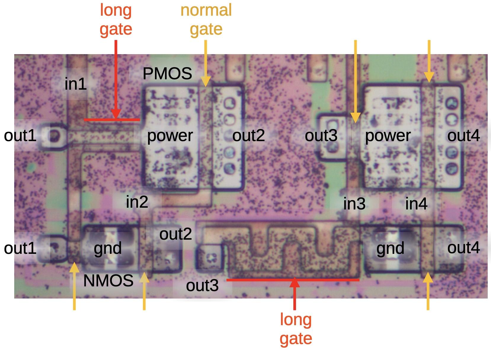

The ternary input
A weird feature of the chip is the input pin that selects the ratio between the input clock and the filter frequency. In effect, this is a digital input with three values. Tying the pin to the high supply voltage selects a 50:1 ratio. Tying the pin to the midpoint between the supply voltages selects a 100:1 ratio. Pulling the pin to the low supply voltage stops the filter and puts the chip into a low-power mode.8
To handle the three-level input, the input goes through two separate buffers, one that transitions at a lower voltage and one that transitions at a higher voltage. Thus, the two buffers separate the middle signal level. Each buffer consists of a special inverter feeding into a regular inverter.

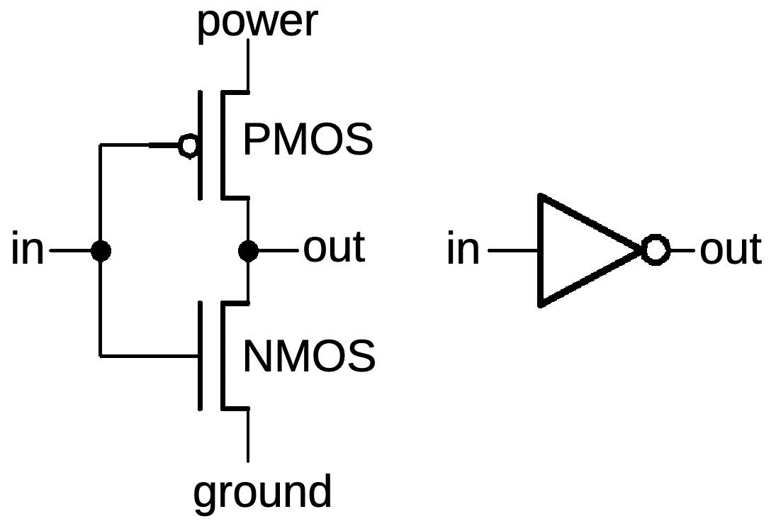

Before explaining the special inverters, I'll review how a regular CMOS inverter works. A CMOS inverter is constructed from a PMOS transistor and an NMOS transistor. When the input is high, the NMOS transistor turns on and pulls the output to ground. When the input is low, the PMOS transistor turns on and pulls the output high. Thus, the input signal is inverted.
In the die photo, you can see the four PMOS transistors (light gray) and four NMOS transistors (darker), forming four inverters. When a polysilicon line (copper-colored) crosses a doped silicon region, it forms the gate of a transistor. For this picture, I dissolved the metal layer in acid so the transistors are visible. The metal layer connected the transistors to complete the wiring of the inverters: it connects the two "out1" contacts to "in2" and connects the two "out2" contacts to the rest of the chip. For the second buffer, "out3" connects to "in4" and so forth.
The four inverters that handle the ternary input. I flipped the image to make the orientation better.
In this circuit, the length of the transistor gates is varied to make the inverters activate at different voltage levels. Six of the transistor gates are normal (orange arrows); the PMOS gates are wider (in the vertical direction) than the NMOS gates because PMOS transistors are inherently weaker. However, two of the transistor gates are unusually long (horizontal direction, red), making the transistors weak since the current must travel a longer distance. The inverter on the left has a weak PMOS transistor. If the input is high or low, the inverter will operate normally. But if the input is in the middle, both transistors will partially turn on. Since the PMOS transistor is very weak, the NMOS transistor will "win", pulling the output low. Thus, the leftmost inverter treats a medium-level input as a 1, outputting a 0. The third inverter is the opposite; the NMOS transistor has a long, winding gate, so it is weak. In this case, a medium-level input will partially turn on both transistors, but the PMOS transistor will "win", pulling the output high. To summarize, the two inverters have opposite behavior for a middle-level signal, allowing the three input levels to be distinguished. Since the output from a special inverter may be weak, the output goes to a normal inverter to amplify the signal.

  2. You might wonder why the larger capacitors are formed by connecting eight smaller capacitor squares, rather than making one capacitor that is eight times as big. The reason is to get better matching between the two capacitor sizes. A capacitor that is eight times as large won't have exactly eight times the capacitance due to factors such as the behavior of the electric field around the edge of the capacitor, inaccuracies that may make the capacitor slightly larger or smaller than desired, or etching variability around the edges. By building larger capacitors out of identical smaller capacitors, the values can match very well, up to ±0.01% according to The Art of Analog Layout. (With laser trimming, matching of ±0.001% is possible, but that is much more accuracy than the MF10 required.) ↩

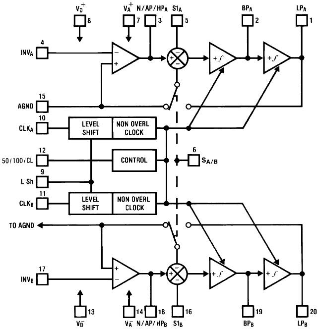

  6. For reference, the full block diagram of the chip is below, from the datasheet.
    Block diagram of the MF10 from the Texas Instruments datasheet.
