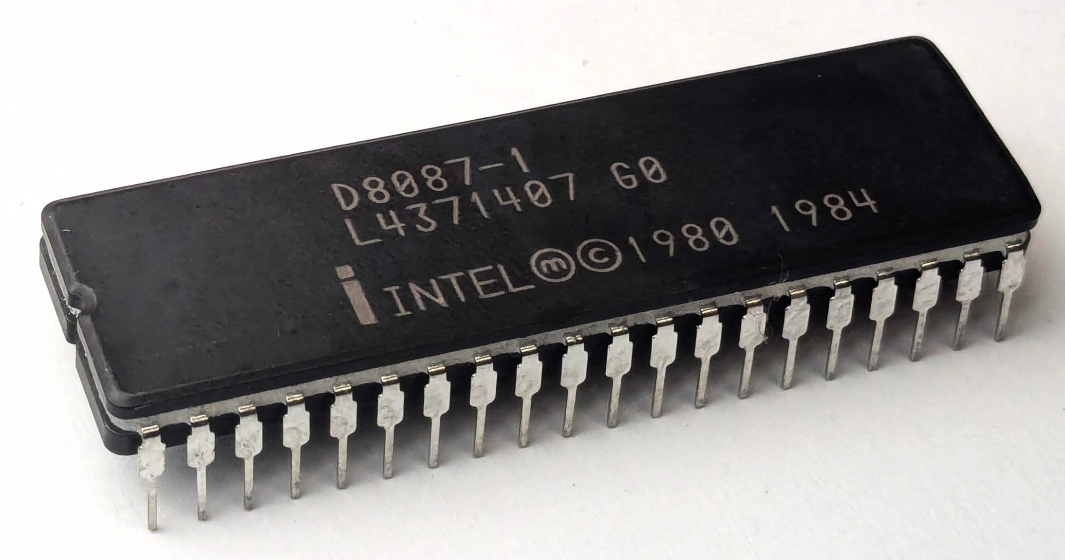

The Intel 8087 chip is packaged in a 40-pin DIP (dual in-line package).

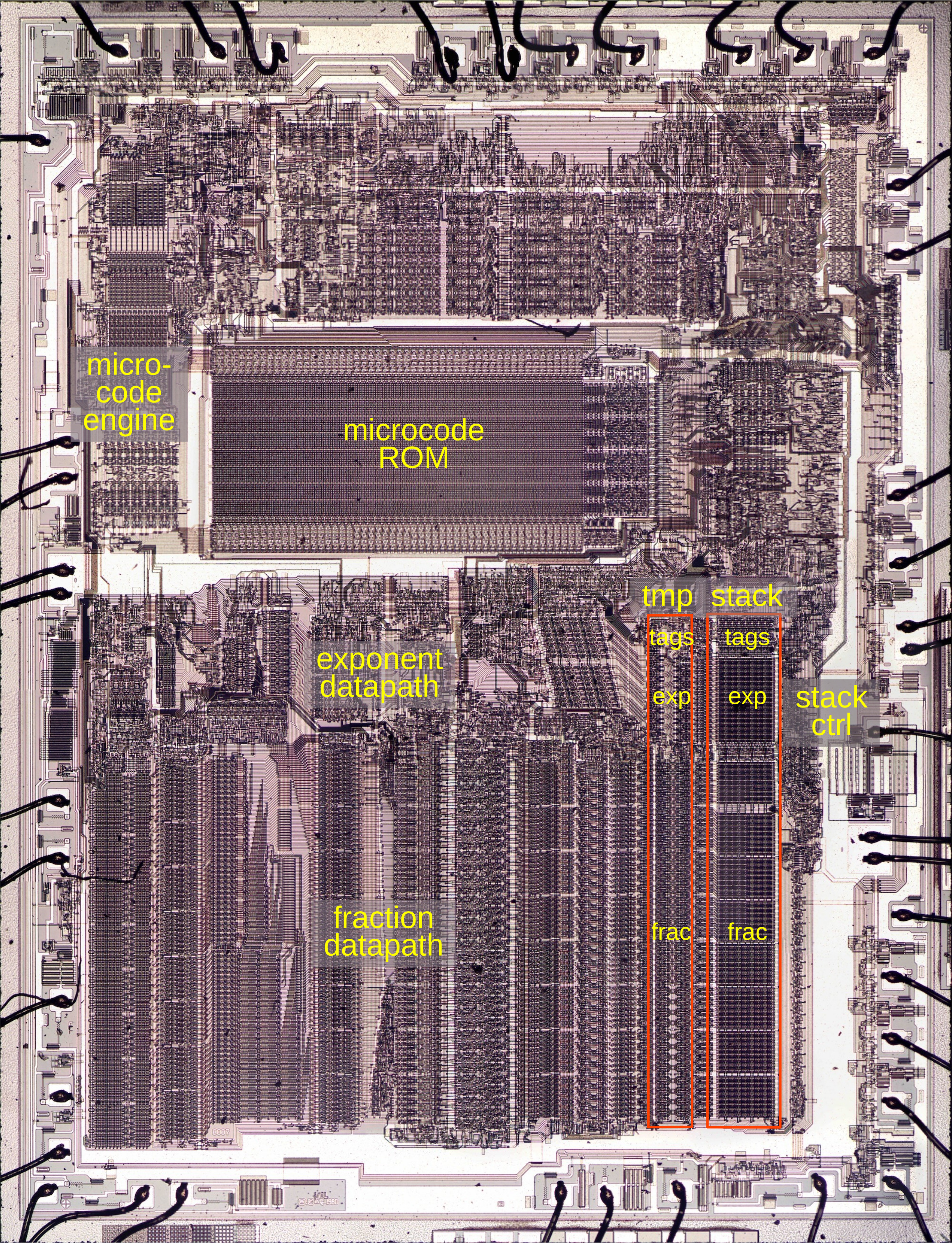

To explore the microcode, I opened up an 8087 chip and created a high-resolution image with a microscope. The large microcode ROM occupies a central position, holding the micro-instructions that control the chip. The microcode engine on the left steps through the microcode, handling jumps and subroutine calls. The bottom half of the chip is the "datapath", the circuitry that performs floating-point calculations; it is split into a 16-bit datapath for the number's exponent and a 64-bit datapath for the number's fractional part (also known as the significand).
Die of the Intel 8087 floating-point unit chip, with main functional blocks labeled. The die is 5mm×6mm.  Click for a larger image.
This post focuses on the temporary registers and stack registers that are highlighted in red. The chip has two temporary registers and eight stack registers, each holding a number's exponent and fraction. Each register also has two tag bits that label the type of value in the register. The stack control circuitry at the right manages the stack, keeping track of the top-of-stack position as values are pushed onto the stack or popped off the stack.

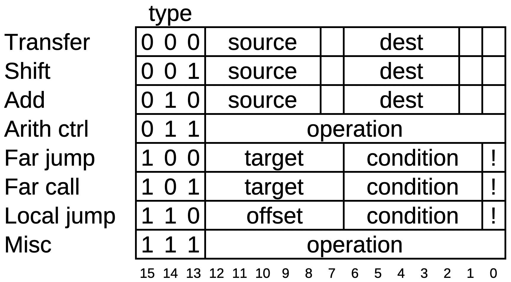

The 8087's micro-instructions are complicated, with many corner cases and ad hoc functions, but I'll provide a simplified overview. Each micro-instruction consists of 16 bits, as shown below. The first three bits specify the type of the micro-instruction, which controls the meaning of the remaining bits. The first type indicates a transfer operation, transferring data from one internal register to another. The two fields specify the source and destination for the data. The three unspecified bits are used for various special cases. Next is a shift operation, which uses the barrel shifter to shift a value left or right. The third type of micro-instruction uses the adder/subtractor. It can also be used in a loop for multiplication or division. Fourth are various arithmetic control micro-instructions that configure the adder, set rounding modes, and so forth. The far jump and far call micro-instructions perform a jump or subroutine call to a target micro-address in a fixed list. The condition field allows conditional jumps/calls based on numerous conditions, while the last bit inverts the condition. A local jump allows a conditional jump to a nearby micro-instruction. Finally, the miscellaneous micro-instructions range from returning from a subroutine or raising an exception to ending the microcode execution.
Structure of an 8087 micro-instruction.

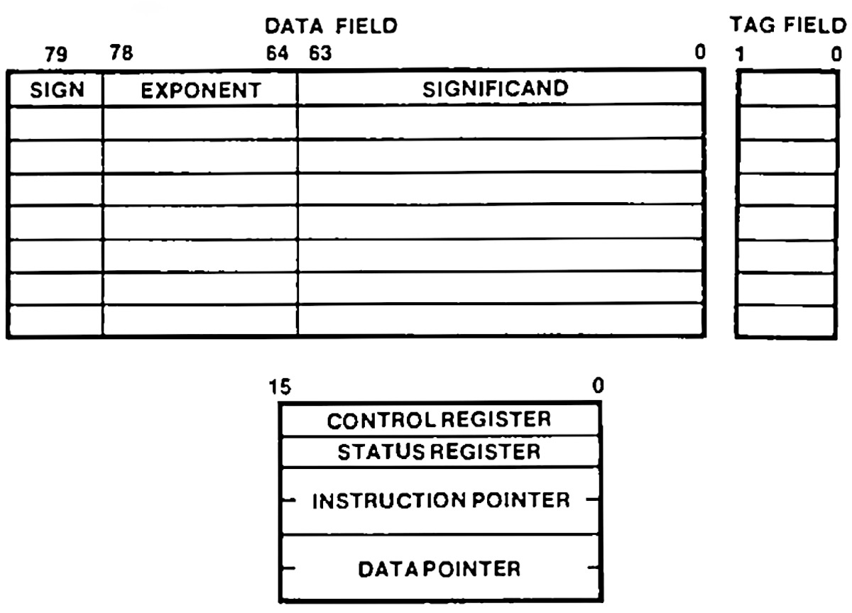

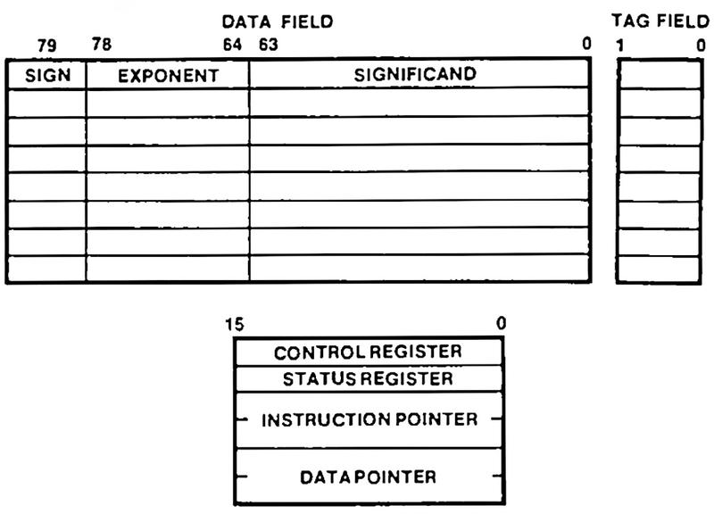

The 8087 supports a variety of data types: floating-point numbers of various sizes, integers, and binary-coded decimal. But internally, everything is stored as an 80-bit floating-point number. A number has three parts: a 64-bit significand (the fractional part), a 15-bit exponent, and a sign bit. The chip has two separate data paths: one for the significand, and one for the exponent and sign.
The chip has eight registers to store numbers during calculations, the top registers in the diagram below. However, the registers are organized in an unusual way: as a stack, with numbers pushed to the stack and popped from the stack. Instead of accessing, say, register #3, you might access the third register from the top of the stack, denoted ST(3); as values are pushed or popped, ST(3) changes. The stack-based architecture was intended to improve the instruction set, simplify compiler design, and make function calls more efficient, although it didn't work as well as hoped.
The register set of the 8087, as seen by the programmer. From 8086 Family Numerics Supplement.
Many 8087 instructions act on the top of the stack. For instance, the square root instruction replaces the value on the top of the stack with its square root. But what if you want to take the square root of a value in the middle of the stack? The solution is the FXCH instruction, the focus of this article. This instruction exchanges the value on the top of the stack with a specified stack position, providing access to values inside the stack.
One more feature of the 8087 is important to this discussion: each value in the register stack has an associated "tag" value, labeling it as valid, special, zero, or empty. A "normal" floating-point value is tagged as valid. If the floating-point value is infinity, Not a Number, or a denormalized value, then it is tagged as special. A zero value is tagged as zero. Finally, if a register is empty (e.g., its value has been popped off the stack), the register is tagged as empty. The 8087 uses tags to optimize performance and detect errors.1 For instance, if a programmer pops too many values from the stack and tries to read a stack register that is tagged empty, the 8087 raises an "invalid operation" exception.
The eight stack registers are visible to the programmer, but the 8087 also has temporary registers that it uses internally. Two of these temporary registers are important for this article: tmpA and tmpB. Like the stack registers, each temporary register is an 80-bit register, along with two tag bits.

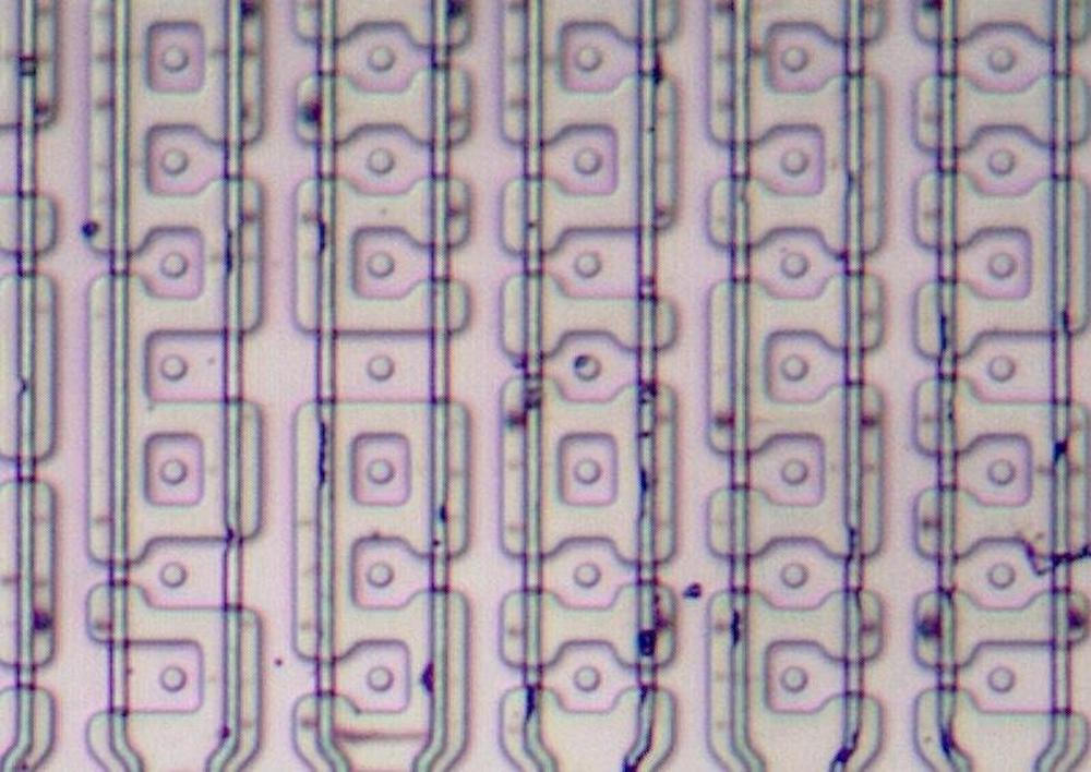

The 8087's microcode ROM contains 26,368 bits, specifying 1648 16-bit micro-instructions. At the time, this was a very large ROM; in order to fit it on the die, Intel used a special type of ROM that held two bits per transistor, twice the capacity of a standard ROM. This ROM is semi-analog, using four sizes of transistors to produce four voltage levels. Comparators convert the voltage level to a pair of bits.
A close-up of the 8087's microcode ROM, showing 77 transistors. A transistor is formed where a vertical polysilicon line crosses a horizontal stripe of doped silicon.
To extract the microcode, I took high-resolution images of the ROM after dissolving the metal layer. Gloriouscow used a neural network to categorize the size of each transistor. (You can explore the full image and transistors here.) The next step was determining how to map the transistors to bits. You might expect that the grid of transistors corresponds to the grid of microcode bits. But due to various hardware optimizations, rows and columns are shuffled and mirrored, which I sorted out by studying the circuitry. The result was the microcode, expressed as a table of 0's and 1's.
