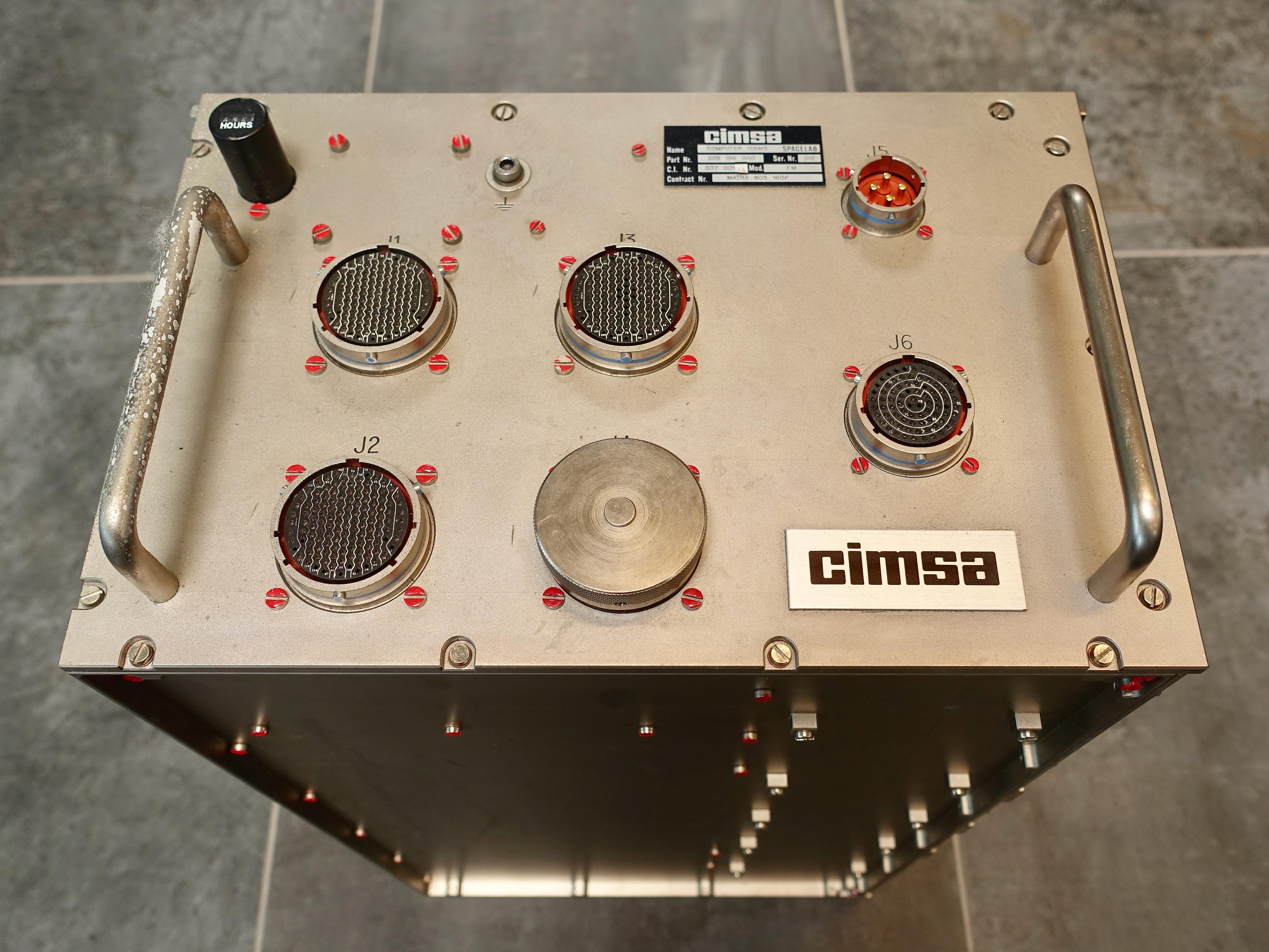

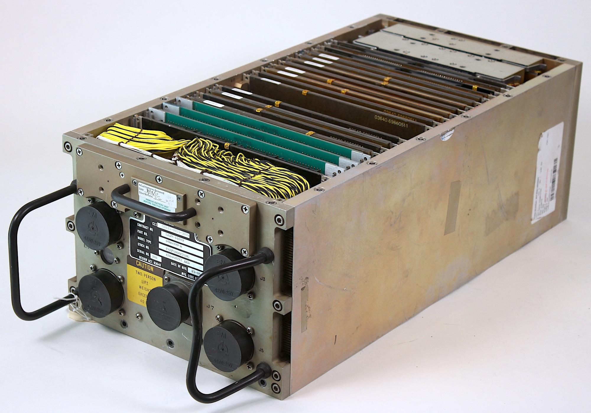

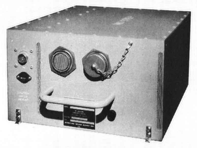

The Space Shuttle AP-101B computer. This unit flew on multiple flights, including STS-38 (1990) and STS-40 (1991). Photo courtesy of RR Auction.

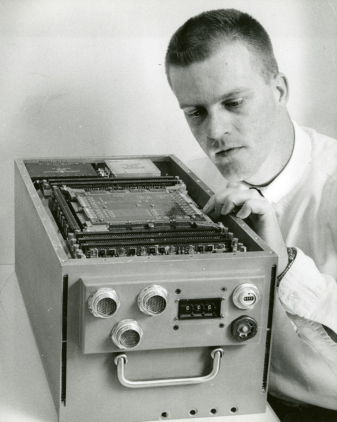

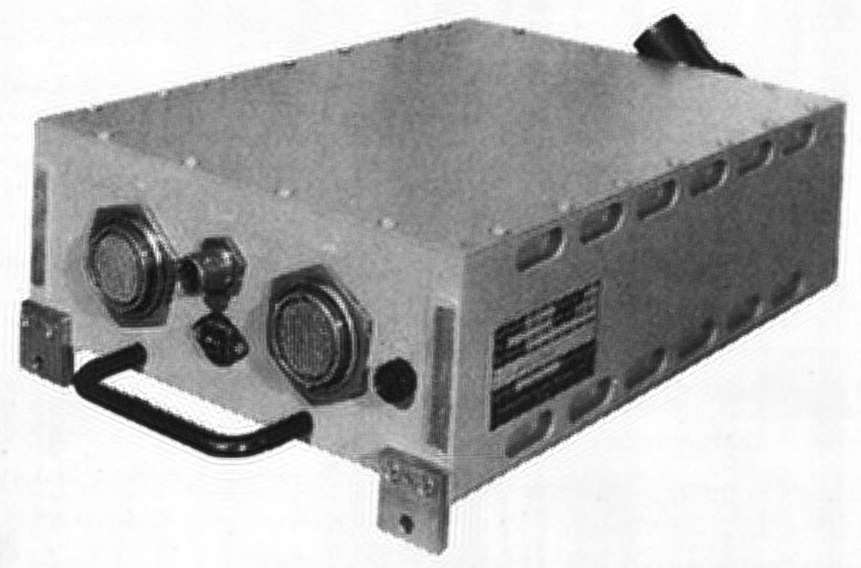

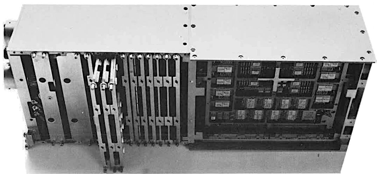

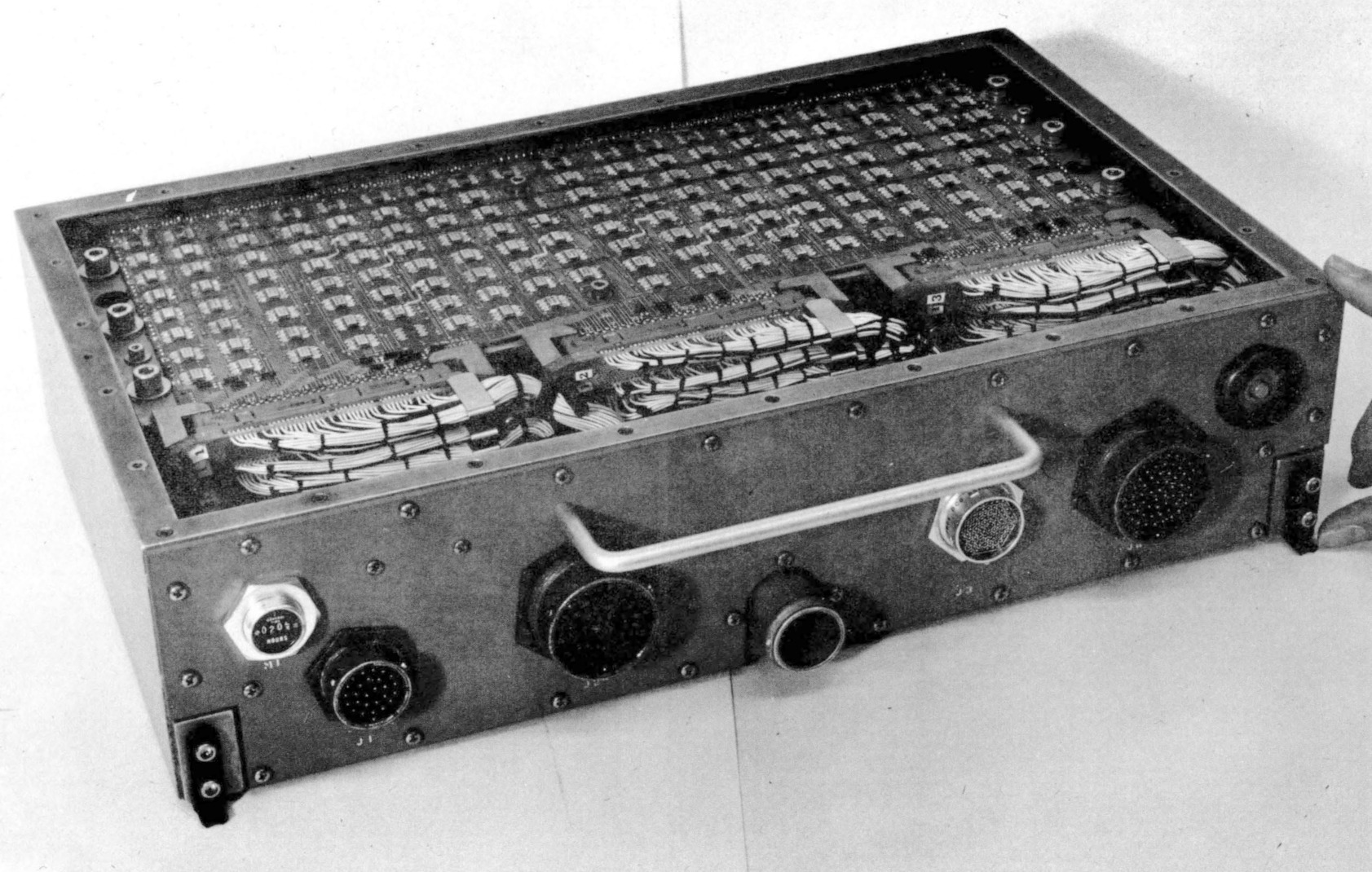

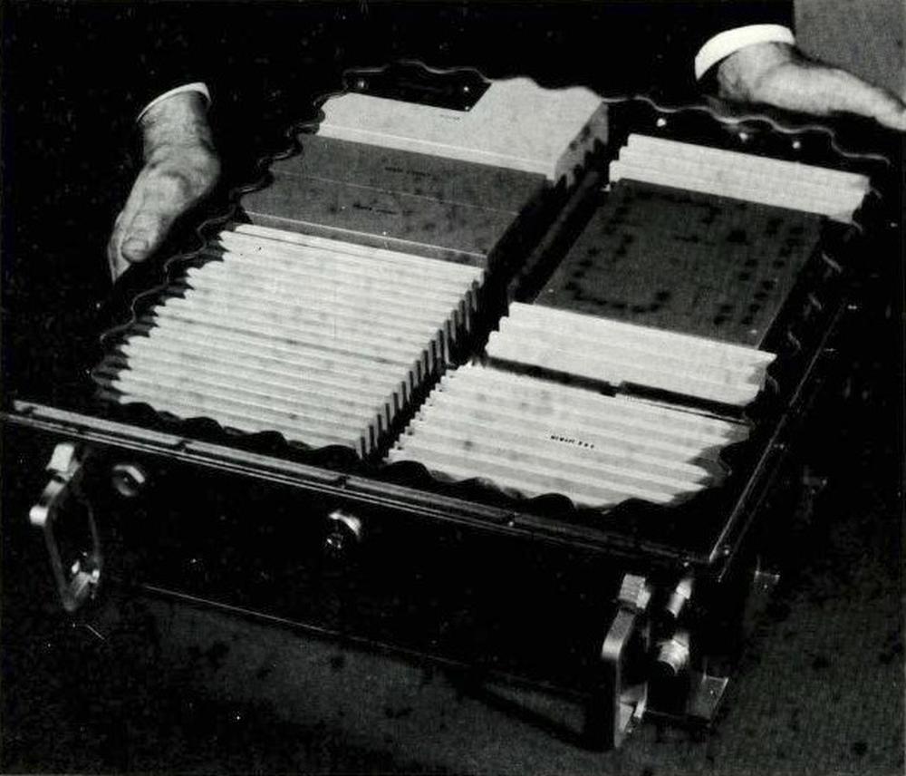

The TC was originally packaged in a briefcase-sized box (9.75" × 17.12" × 4.0") (below) that weighed 17.3 pounds, but it could be repackaged for different applications. For a tactical missile, the computer was implemented on semicircular circuit boards as shown above. The computer was constructed from TTL (Transistor-Transistor Logic)3 flatpack integrated circuits mounted on four-layer circuit boards. Two circuit boards made a sandwich around a metal structure that provided support and cooling; this three-layer assembly was called a "page". A page could hold about 300 integrated circuits, so the computer was very dense.
The IBM 4 Pi TC system. From Technical Description of IBM System 4 Pi Computers.

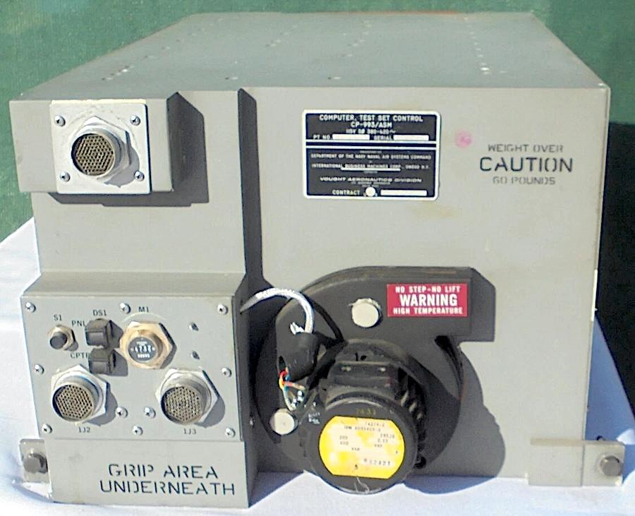

The TC-2 model (below) was much faster (125,000 operations per second) and weighed 80 pounds. It was used for Navigation/Weapons Delivery in the A-7D/E attack fighter. In 1976, it was upgraded to the TC-2A, which was still faster (454,000 operations per second), supported more memory, and added 12 more instructions.

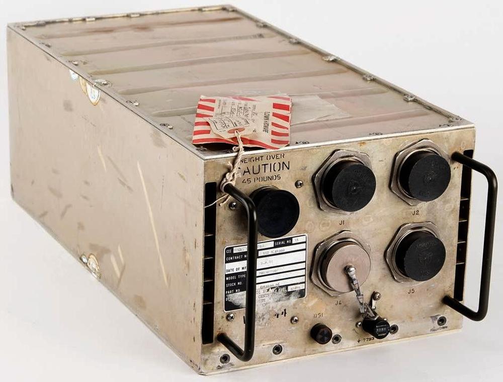

A TC-2 computer, specifically the Test Set Control Computer CP-993/ASM. It looks the same as the A-7 aircraft's CP-952/ASN-91(V) computer.
Photo courtesy of Alex1970-14;
this computer is currently on eBay if you want it.
A TC-2 computer, specifically the Test Set Control Computer CP-993/ASM. It looks the same as the A-7 aircraft's CP-952/ASN-91(V) computer. Photo courtesy of Alex1970-14; this computer is currently on eBay if you want it.

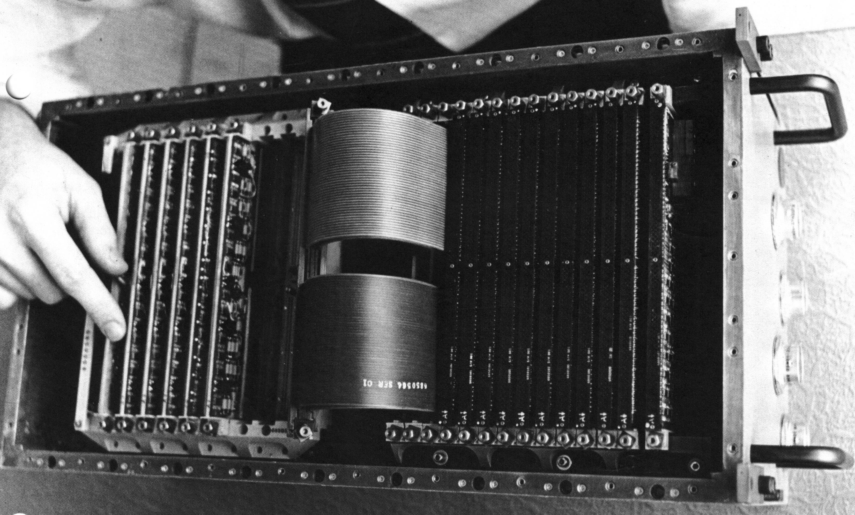

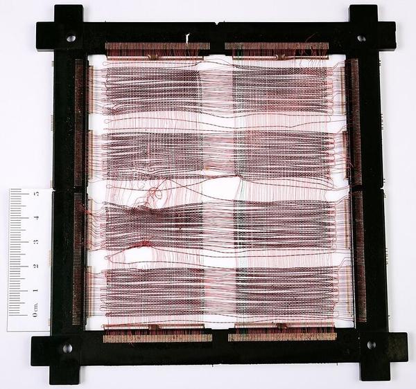

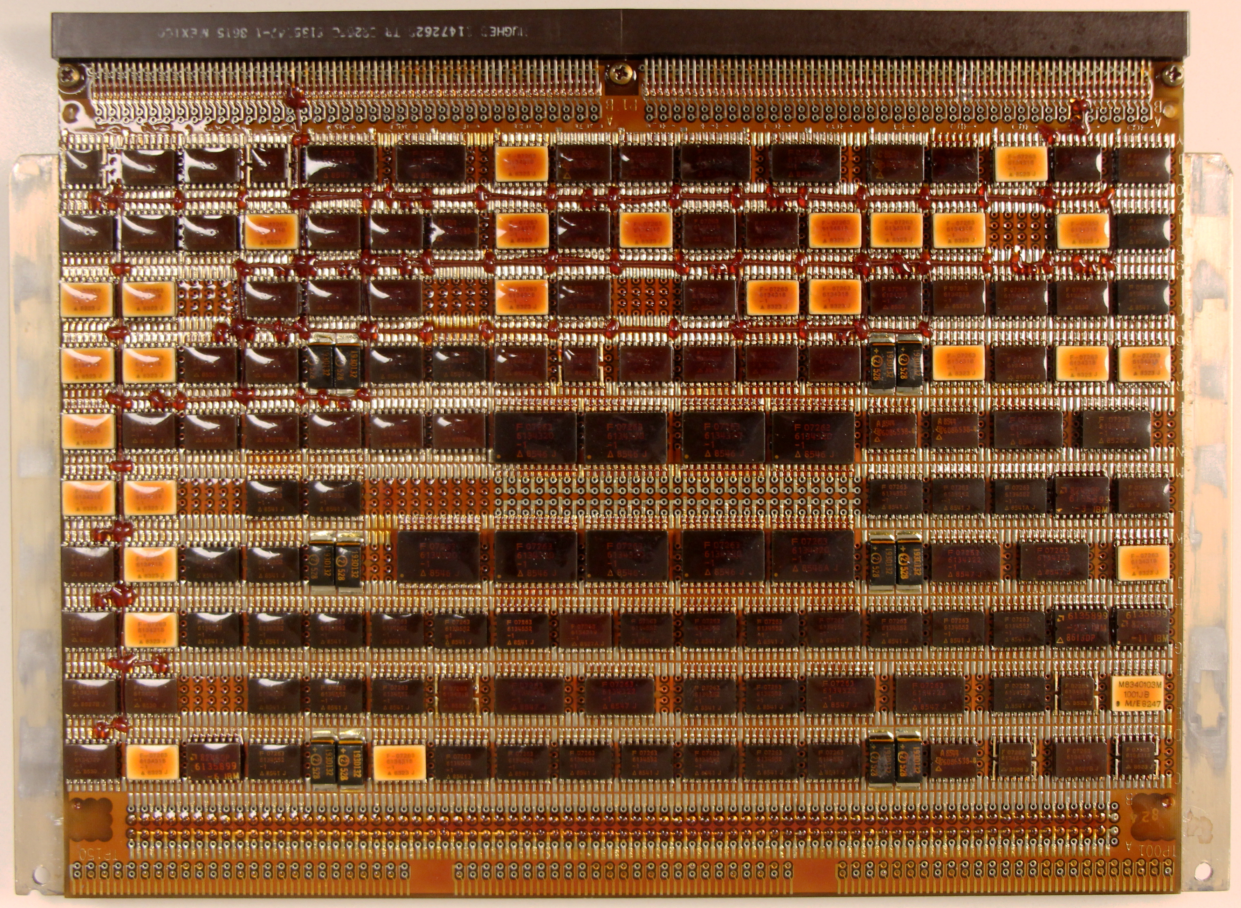

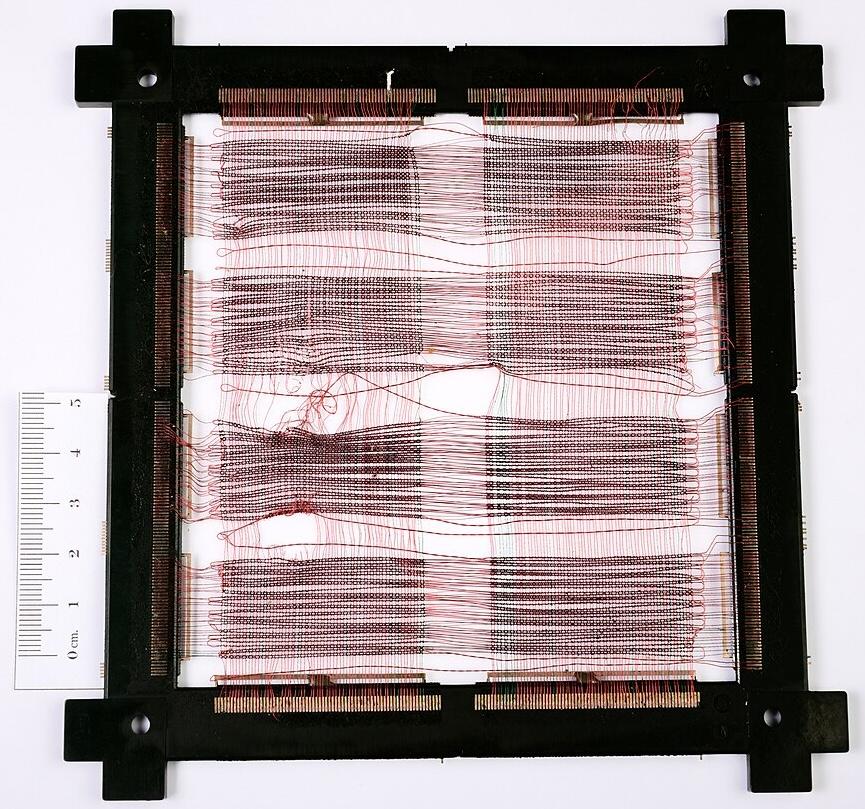

Like most computers in its era, the TC used magnetic core memory; each bit was stored in a tiny toroidal core of lithium nickel ferrite, strung onto a grid.5 The core planes in the TC and other first-generation 4 Pi computers were about 6 inches on a side. With 16,384 cores in a plane, each plane held 16 Kbits. Thus, the 8-kilobyte memory in the TC required a stack of four core planes. A significant advantage of core memory was that, because it was magnetic, the data was preserved even when the memory was not powered. It was also highly resistant to radiation.
This (somewhat damaged) core memory plane is the commercial version of the planes in the first-generation System/4 Pi computers.
Photo by José Luis Briz Velasco, CC BY-SA 4.0, cropped.
This (somewhat damaged) core memory plane is the commercial version of the planes in the first-generation System/4 Pi computers. Photo by José Luis Briz Velasco, CC BY-SA 4.0, cropped.

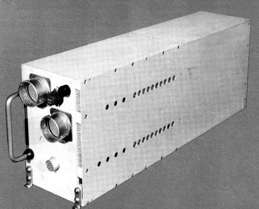

The CP Customized Processor
One step up from the TC series was the CP Customized Processor (briefly called Cost Performance).6 It used a 16-bit CPU, but had a wide 36-bit bus to memory for higher performance (including two parity bits and two storage protection 7 bits). Unlike the TC series, the CP series was (optionally) microcoded internally, so the instruction set could be easily customized.8 The CP system had completely different instruction formats from the TC system.10 The base model had 36 instructions and executed 91,000 instructions per second. The CP supported multiple addressing modes, more advanced than the simple addressing of the TC system. While the TC ran at 330 kHz, the CP ran at 2.4 megahertz. The CP's performance didn't improve as much as the faster clock would suggest, since both systems used slow core memory.
The IBM CP computer. from "IBM System/4 Pi Model CP" brochure, 1967.

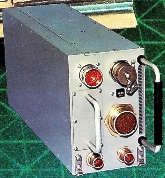

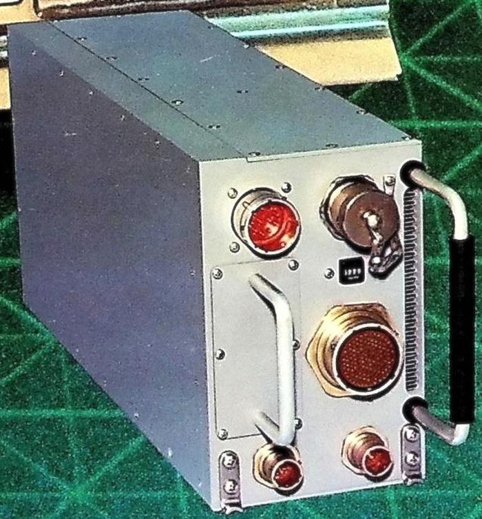

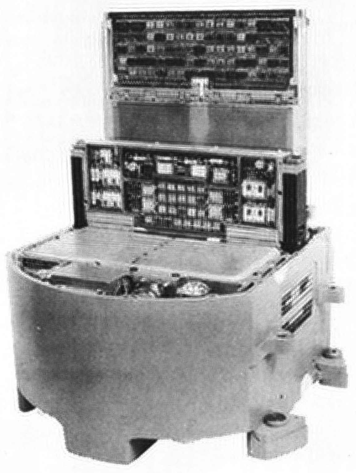

The CP-2 was the navigation/weapons delivery computer in the F-111 fighter plane, integrating radar and weapons. It was faster than the CP-1, perhaps because it was not microprogrammed, executing 150,000 instructions per second. It was also smaller, occupying one 47-pound box, although it had less I/O support. Unfortunately, this F-111 computer was said to be a disaster operationally because the computer had reliability problems and limited performance. The CP-2 was later replaced by the enhanced CP-2EX.
The CP-2 computer, designated the AN/AYK-6. The three-digit dial on the front was covered and fastened with security wire before use, so it must have been important. The core memory stack is in the middle of the computer, with 8K to 16K words of storage. The circuit pages are in front. Photo from an IBM Thread, which also shows a disassembled TC-2 computer.

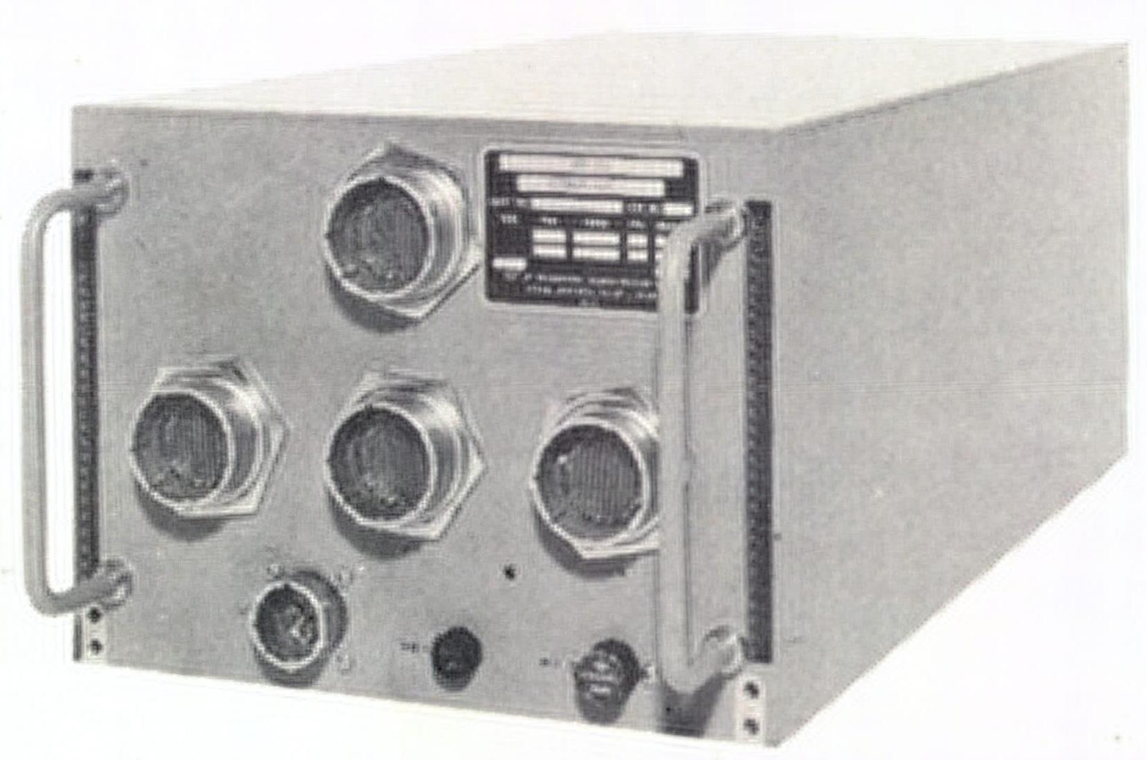

The CP-3 computer (below) was used for navigation and weapons delivery in the A-6E Intruder (1970) and other aircraft, replacing an earlier Litton computer with an unreliable drum memory. This computer could be integrated with laser-guided "smart" bombs. It was similar to the CP-2 and had the same performance, but had different I/O functions.
The CP-3 computer, designated the CP-985/ASQ-133. From "IBM System/4 Pi and Advanced System/4 Pi Computers" brochure, August 1973.

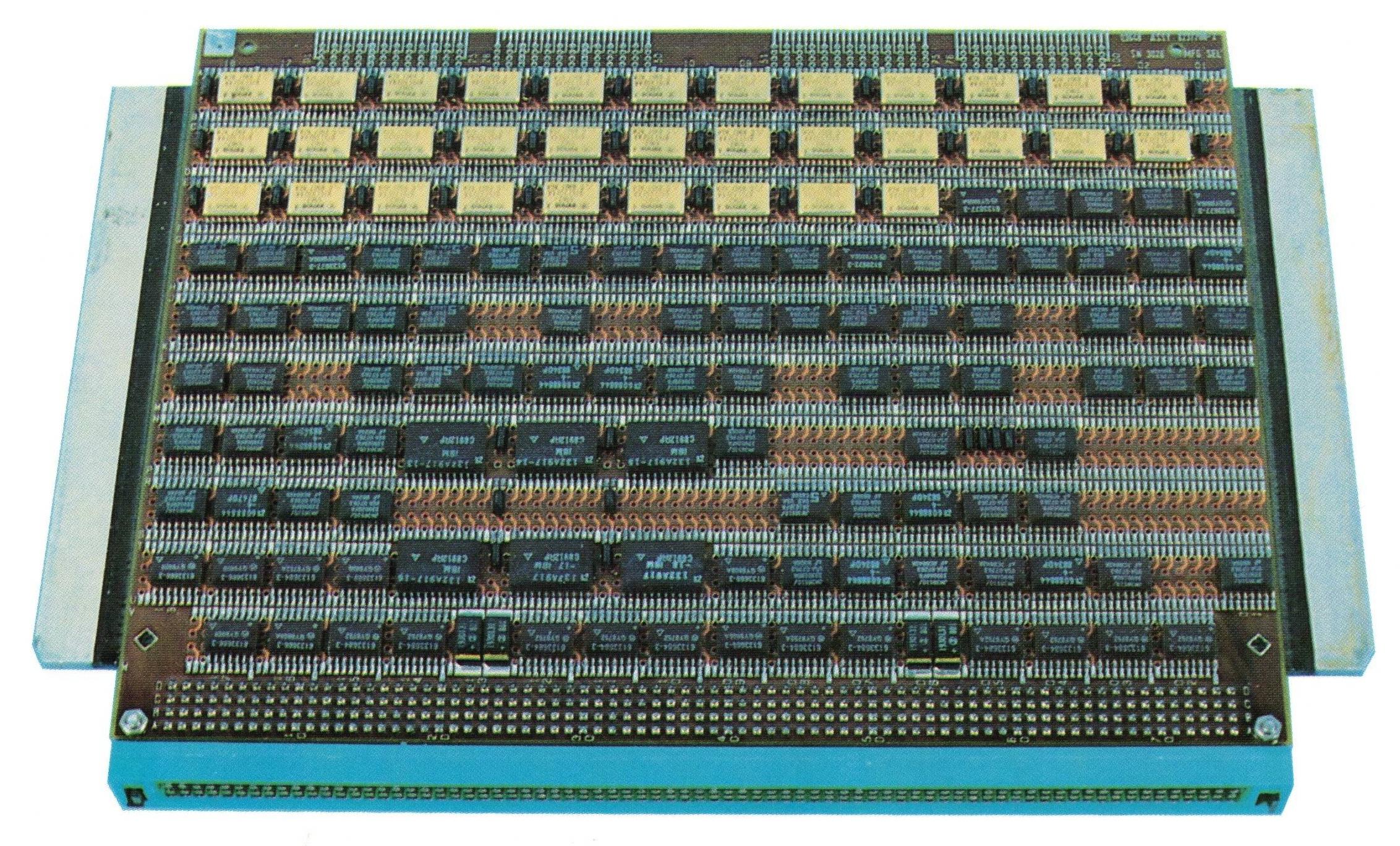

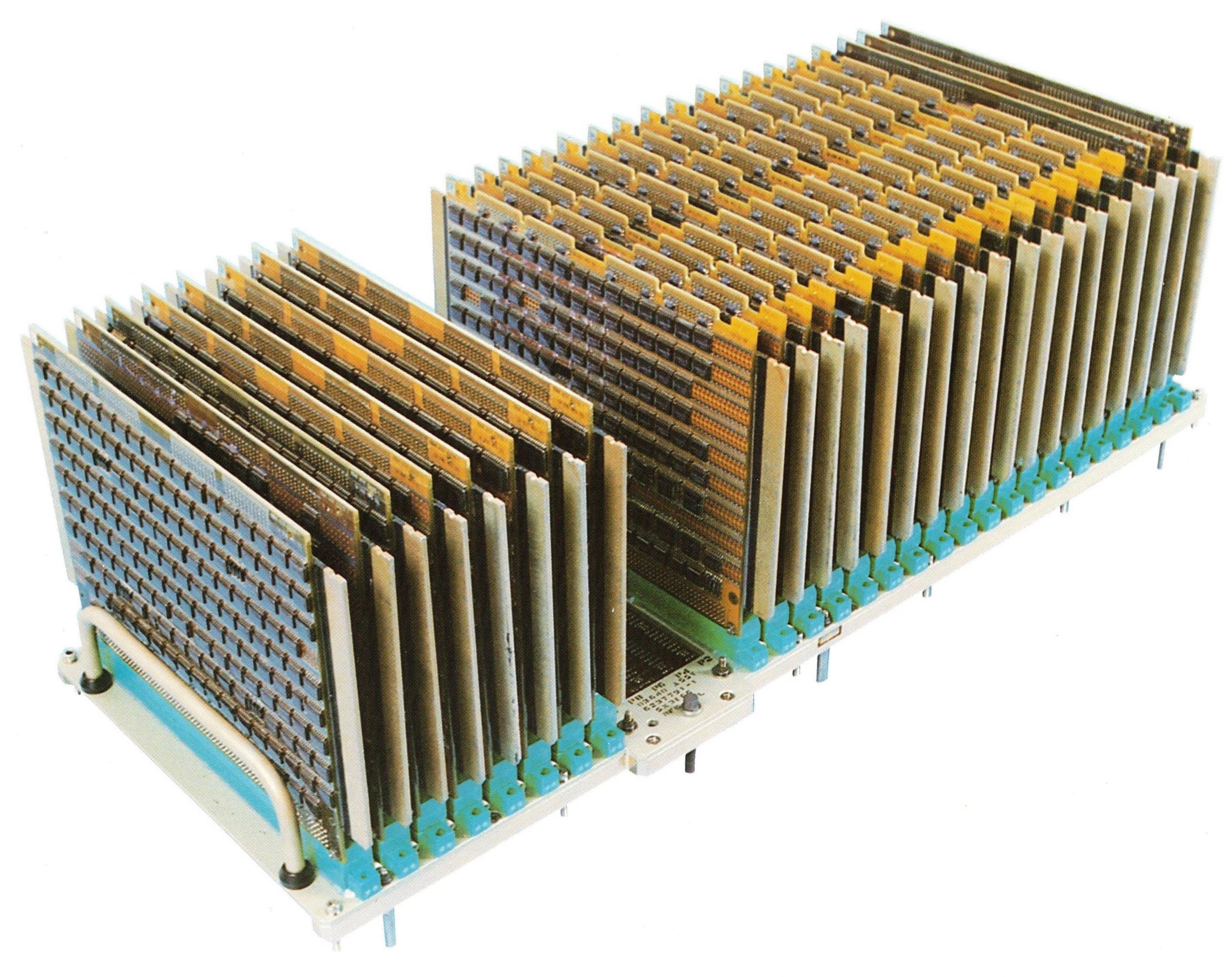

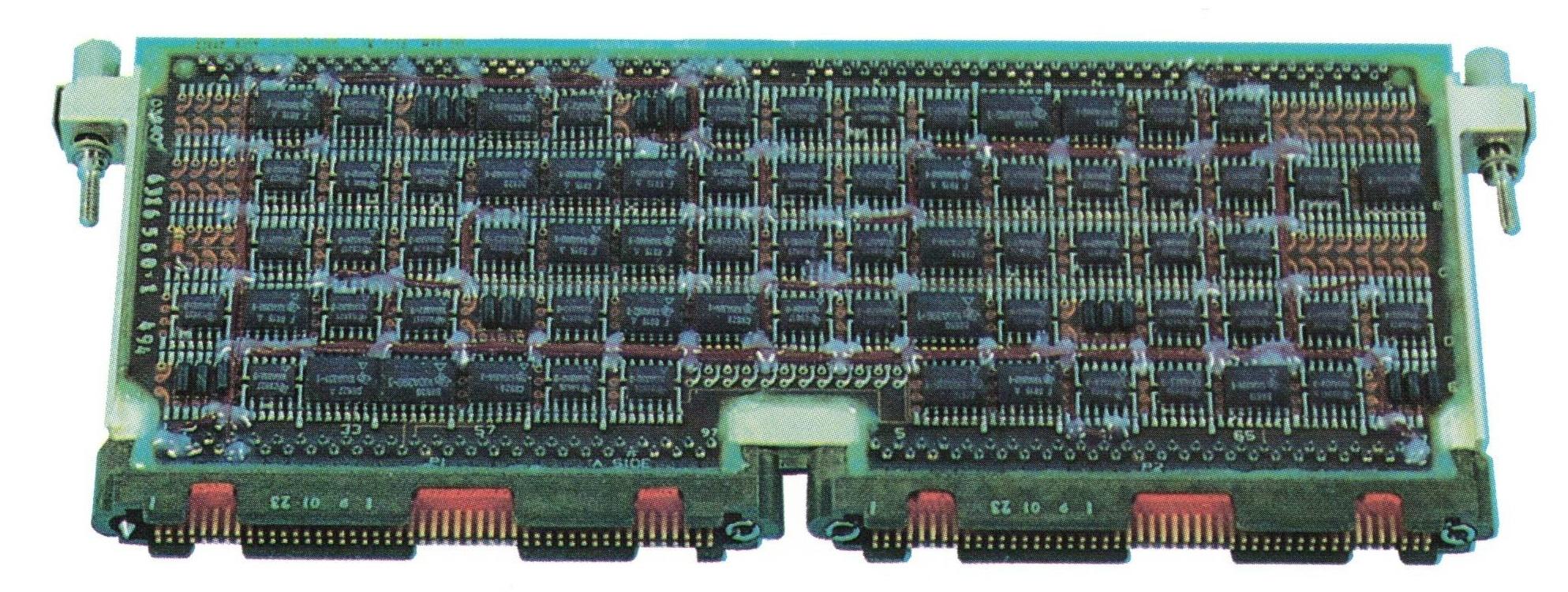

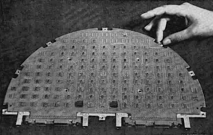

Like the TC, the CP was constructed from flat-pack TTL chips mounted on circuit boards called "pages". However, the CP used smaller pages with six layers instead of four; each double-sided page could hold up to 156 integrated circuits. Each page had two 98-pin connectors, reusing the style of connector that IBM used in Apollo for the Saturn V rocket's Launch Vehicle Digital Computer (LVDC). IBM standardized on this type of page for decades; the page below was used in the AWACS computer (1991) and is almost identical to the pages in the CP computer in 1967.
A standard IBM System/4 Pi page assembly. From "AWACS Data Processing Subsystem" brochure, 1991.

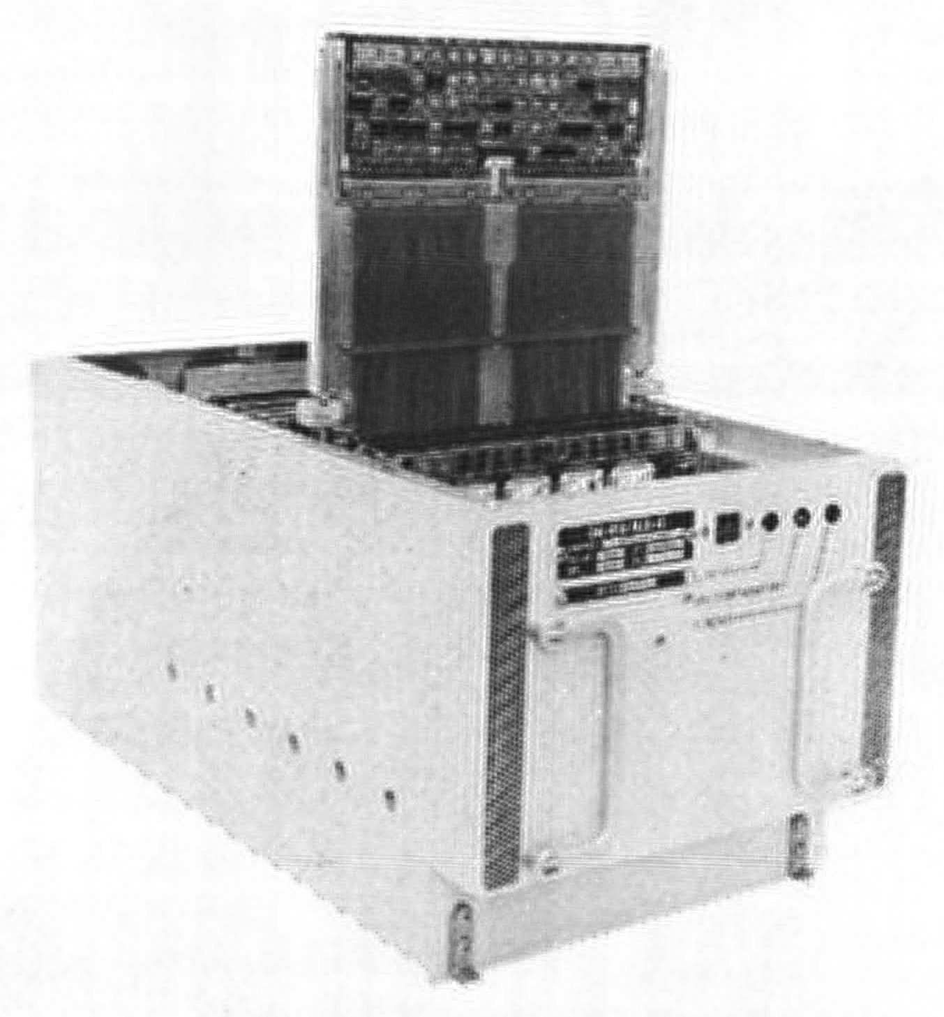

The EP was the most powerful of the original System/4 Pi computers. It was a 32-bit computer compatible with IBM System/360 mainframes, specifically the 360 Model 44.11 For input/output, the EP used the same I/O channel architecture as the System/360 mainframes. To support the complicated 360 instruction set, the EP was microcoded. It executed 190,000 instructions per second and weighed 75 pounds. Floating-point support was available as an option.
A mockup of the EP computer. The core memory is the dark box in the in the upper right, From Technical Description of IBM System 4 Pi Computers.

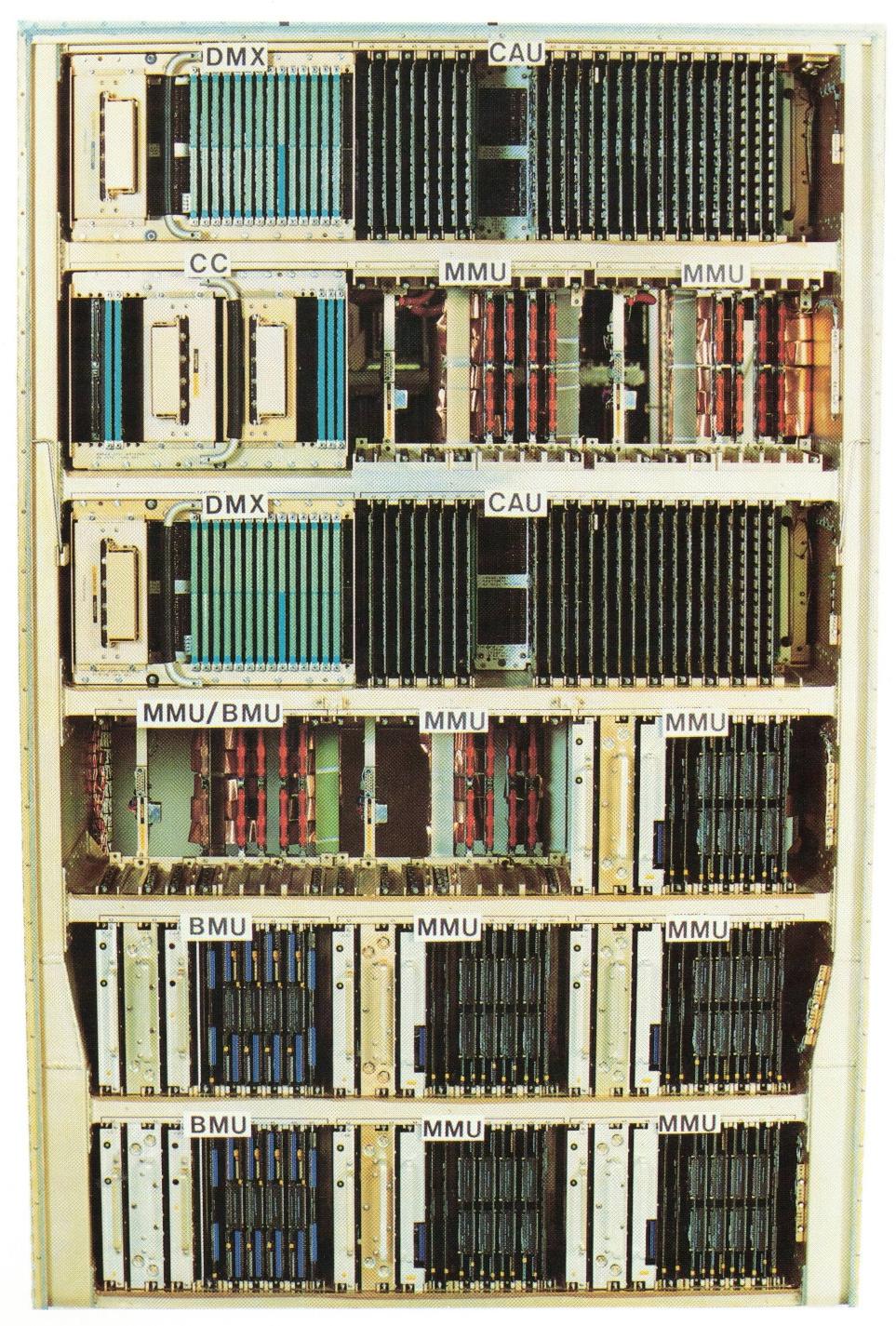

A multiprocessor version of EP, the EP/MP, supported up to three CPUs sharing memory. It was delivered for the Air Force's Manned Orbiting Laboratory (MOL), but the MOL project was canceled (details). The multiprocessor system was also used for the VS ANEW anti-submarine research project, part of the VSX program that led to the Lockheed S-3 Viking, an aircraft that used the System/4 Pi SP-0A computer instead of the EP.

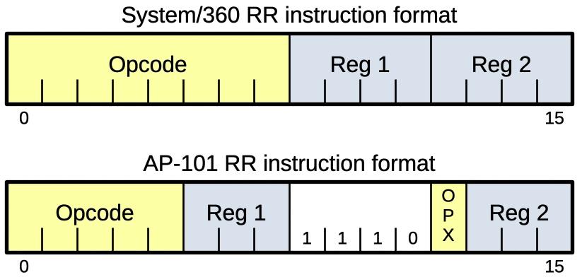

For the most part, the AP computers used an instruction set and architecture that was derived from the System/360, called MMP (Multipurpose Midline Processor).13 Unlike the EP computers, the AP computers were incompatible with System/360: the instruction format, the registers, the addressing modes, and the condition codes were different. Some AP computers used a 16-bit instruction set that was an Air Force Standard, called MIL-STD-1750A.

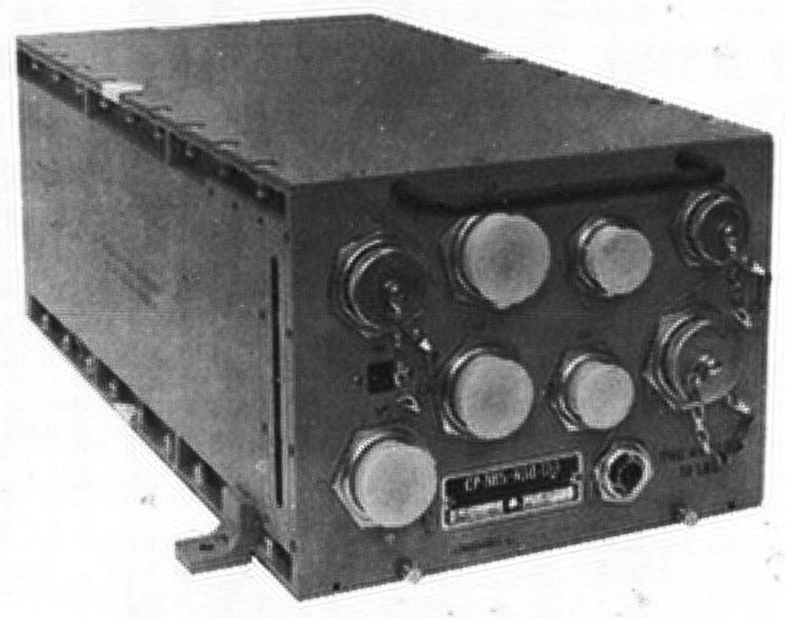

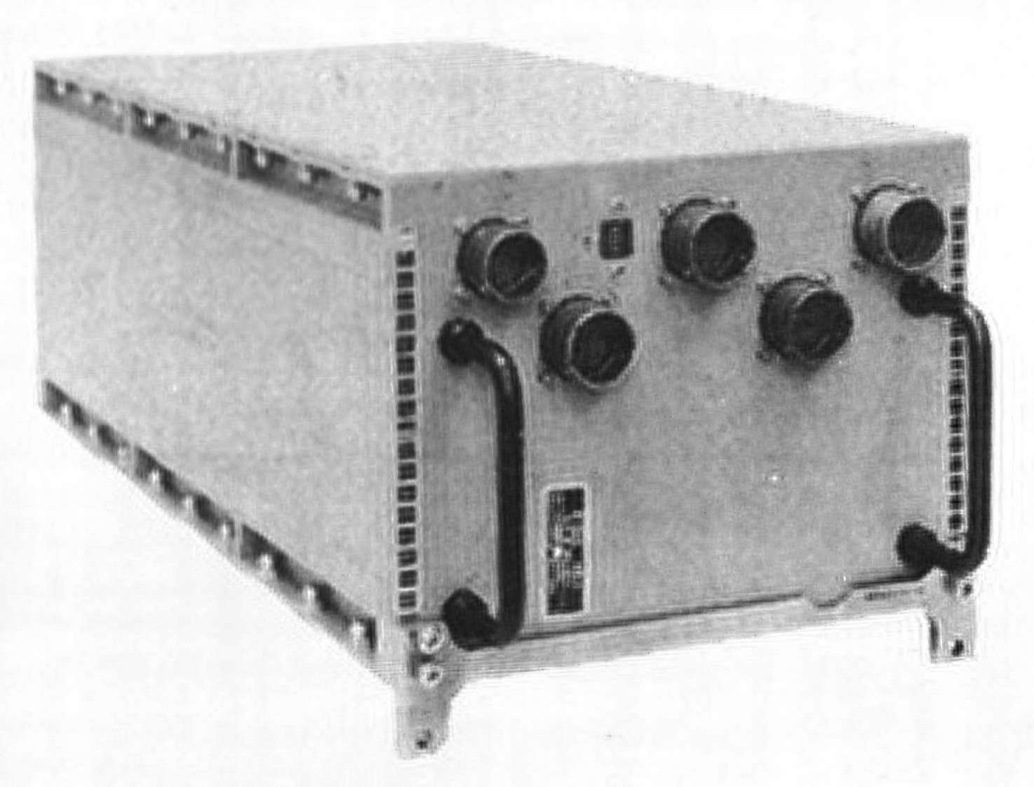

The Advanced Processor line started with the AP-1, a 32-bit processor that performed 450,000 instructions per second and weighed 36 pounds. It could be programmed in assembler or the military's JOVIAL language. It supported 16K halfwords to 64K halfwords of storage internally, and more could be added in an external box. It had four high-speed I/O channels, handling up to 15 devices per channel. Floating point was available as an option. The AP-1 is described in detail here.
The AP-1 computer, designated CP-1075/AYK. From "IBM System/4 Pi and Advanced System/4 Pi Computers" brochure, August 1973.

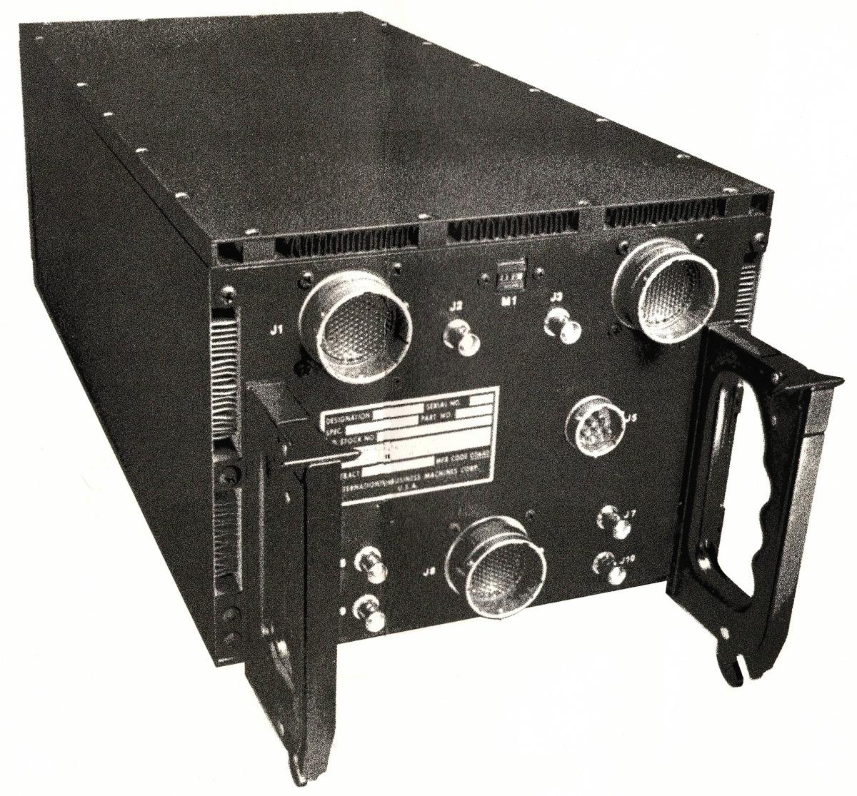

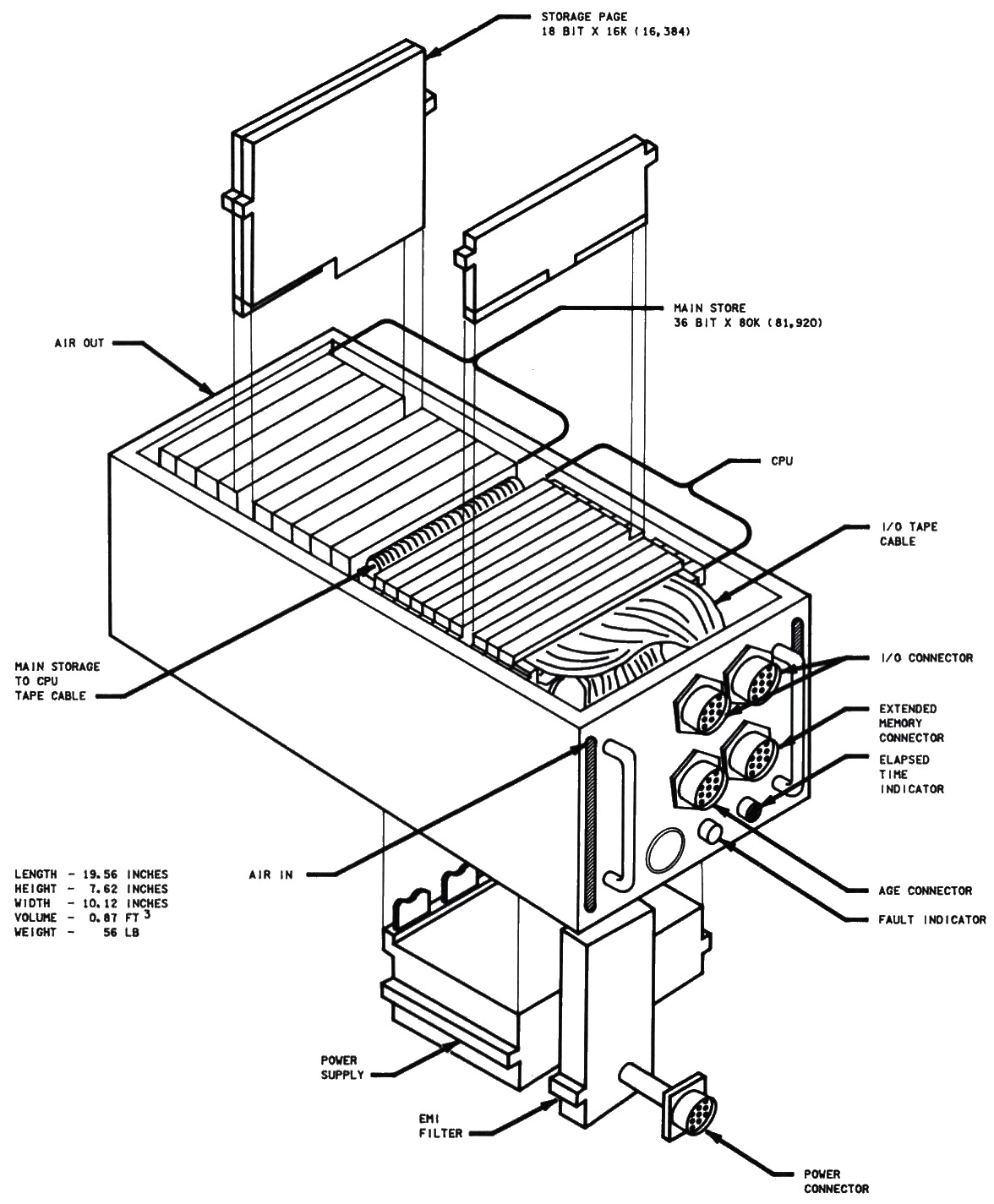

The AP-101 computer expanded the AP-1's instruction set from 83 instructions to 151, as well as having slightly faster core memory. The first nine AP-101 computers were used in NASA's digital fly-by-wire research program that used the F-8 fighter (link). The AP-101 was also used for GPS development.
The AP-101 computer. From "IBM System/4 Pi and Advanced System/4 Pi Computers" brochure, August 1973.

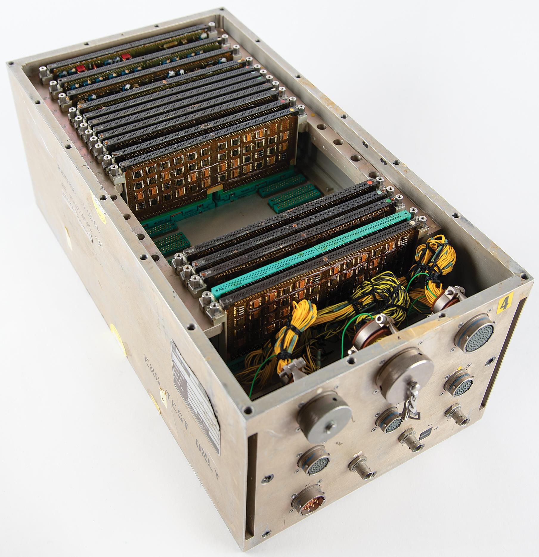

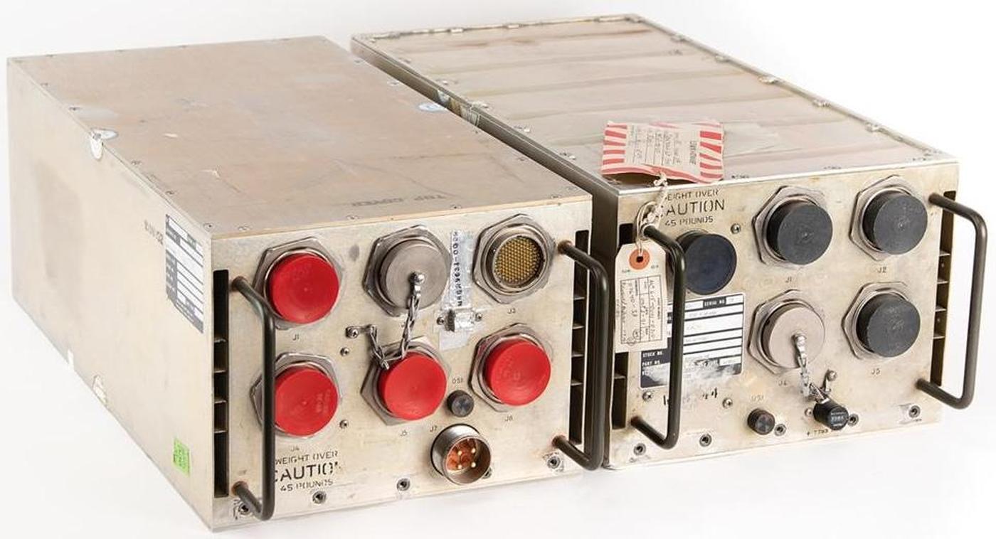

Around 1975, the AP-101B computer was developed for the Space Shuttle.14 The first step was improving the instruction set to support "high order languages" better, resulting in the AP-101A. Next, double-density core memory was used, creating the AP-101B that the Space Shuttle used for many years. The AP-101B computer was partnered with the IOP (I/O Processor), essentially a second computer that handled I/O, providing 24 data buses to the rest of the Space Shuttle. For reliability, the Space Shuttle had four redundant AP-101B computers that ran in parallel and voted on each output, so a faulty computer could be excluded. Moreover, a fifth computer was ready as a backup, using independently programmed software in case a software fault caused all four primary computers to fail.15
The Space Shuttle I/O Processor (IOP, left) and AP-101B computer (right). Photo courtesy of RR Auction.

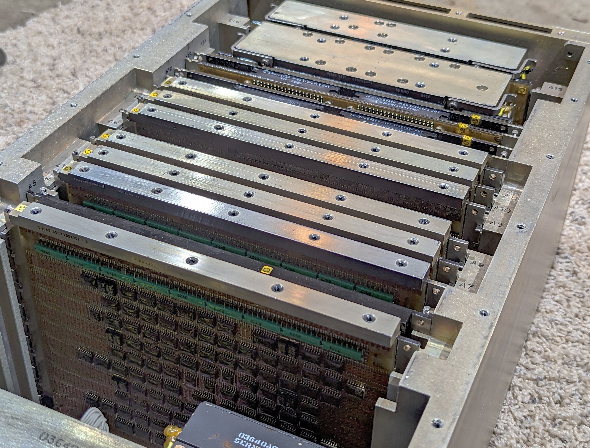

The Space Shuttle computer had 104K 32-bit words of memory. The AP-101B held ten memory pages (i.e., circuit boards), each holding 16K×18 bits, while the IOP held six pages, each holding 8K×18 bits.16 Although the memory was physically split between the two boxes, it acted as a unified shared memory.

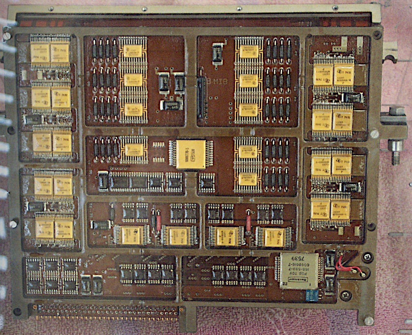

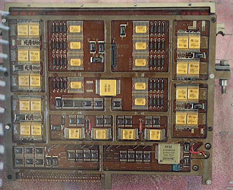

One of the CPU boards from the AP-101S, specifically the CPU1 board. If you look closely, you can see "bodge wires" that correct errors on the board. The nine large ICs in the center are four-bit arithmetic-logic unit chips (74F181) for the 36-bit "fraction" ALU. Much of the logic uses FAST (Fairchild Advanced Schottky Technology) TTL chips for improved performance. The board is covered with brown conformal coating to protect it from the environment. Click this image (or any other) for a larger version.
Like the previous processors, the CPU of the AP-101S was constructed from multiple pages of TTL chips. Unlike the earlier AP-101B, the AP-101S used large "MCS" pages, as shown above. The diagram below illustrates how the upgraded AP-101S computer was formed by combining the pipelined CPU22 from the high-performance AP-101F, the I/O Processor from the original Shuttle computer, and the semiconductor memory from the AP-102 (discussed in the next section).23

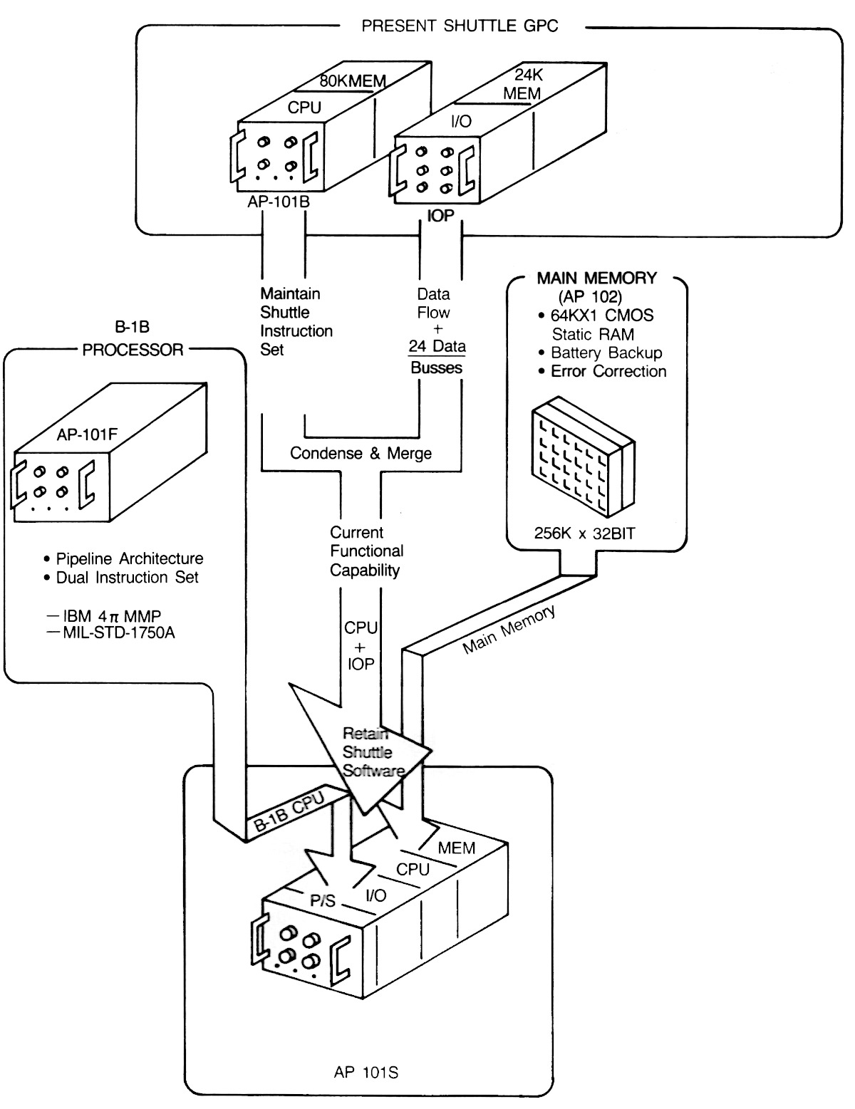

The upgrade path for the Space Shuttle computer. (Click this image (or any other) for a larger version.) From "A New Computer for the Space Shuttle: The AP-101S General Purpose Computer (GPC) Upgrade", IBM Technical Directions, 1986.

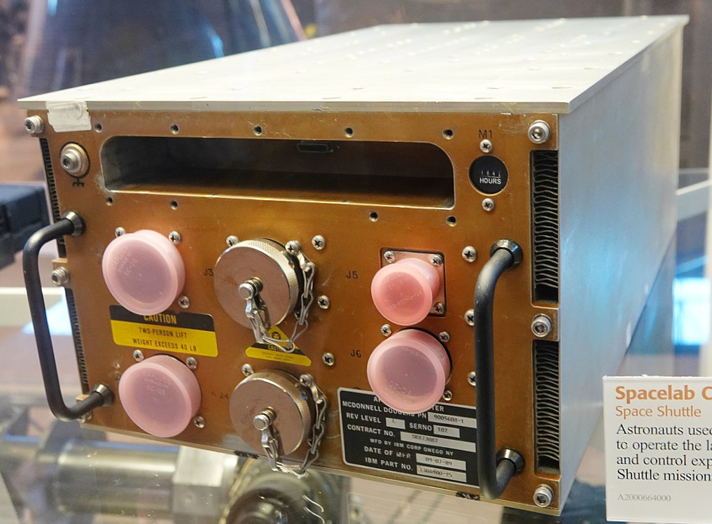

An AP-101SL computer at the National Air and Space Museum, VA. The slot at the top held nickel-cadmium batteries to preserve the contents of the CMOS memory, but the batteries were removed for safety during storage.
Photo by Sanjay Acharya, CC BY-SA 4.0, cropped.
An AP-101SL computer at the National Air and Space Museum, VA. The slot at the top held nickel-cadmium batteries to preserve the contents of the CMOS memory, but the batteries were removed for safety during storage. Photo by Sanjay Acharya, CC BY-SA 4.0, cropped.
Internally, the Spacelab AP-101SL computer is very similar to the Shuttle's AP-101S. It has fewer boards than the AP-101S, since it doesn't include the Shuttle's IOP (I/O Processor). The processor boards, the semiconductor memory,26 and the power supplies are nearly identical to the Shuttle computer, while the I/O boards are different.27

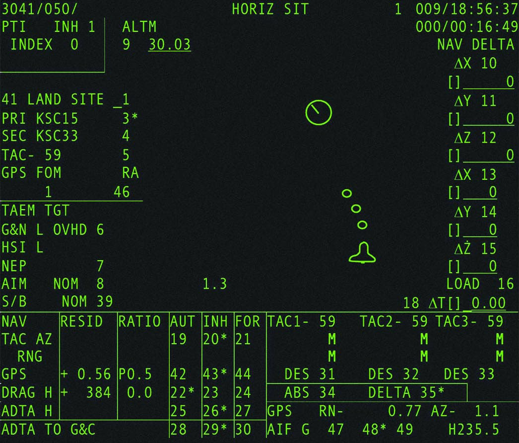

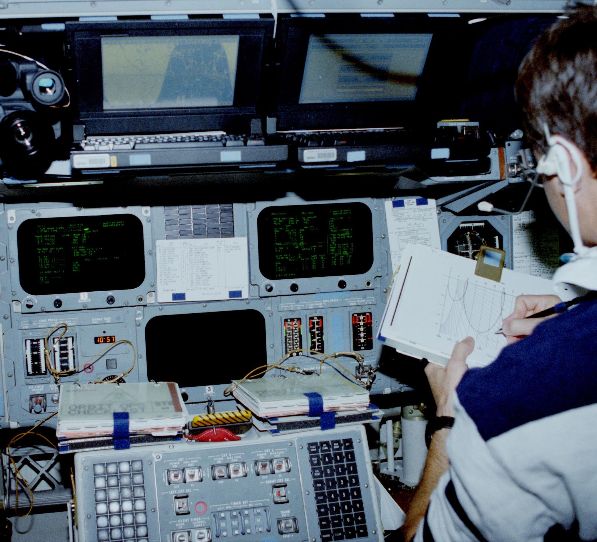

On the Space Shuttle, the astronauts received flight and control information through four screens 30 These monochrome green CRTs displayed text and primitive graphics using vectors—lines drawn on the CRT—rather than pixels. Each screen was controlled by a Display Electronics Unit (DEU).
Three of the Shuttle's CRT displays. (Click for a larger image.) The left screen shows the
Universal Pointing attitude display.
The right screen shows the Relative Navigation screen for rendezvous operations.
At the bottom of the photo are the two grid-style keyboards for communication with the computer, with the CRT controls in between.
Two laptops are sitting on top of the console. Mission Pilot Kevin Chilton is in the pilot's seat. From National Archives.
Three of the Shuttle's CRT displays. (Click for a larger image.) The left screen shows the Universal Pointing attitude display. The right screen shows the Relative Navigation screen for rendezvous operations. At the bottom of the photo are the two grid-style keyboards for communication with the computer, with the CRT controls in between. Two laptops are sitting on top of the console. Mission Pilot Kevin Chilton is in the pilot's seat. From National Archives.

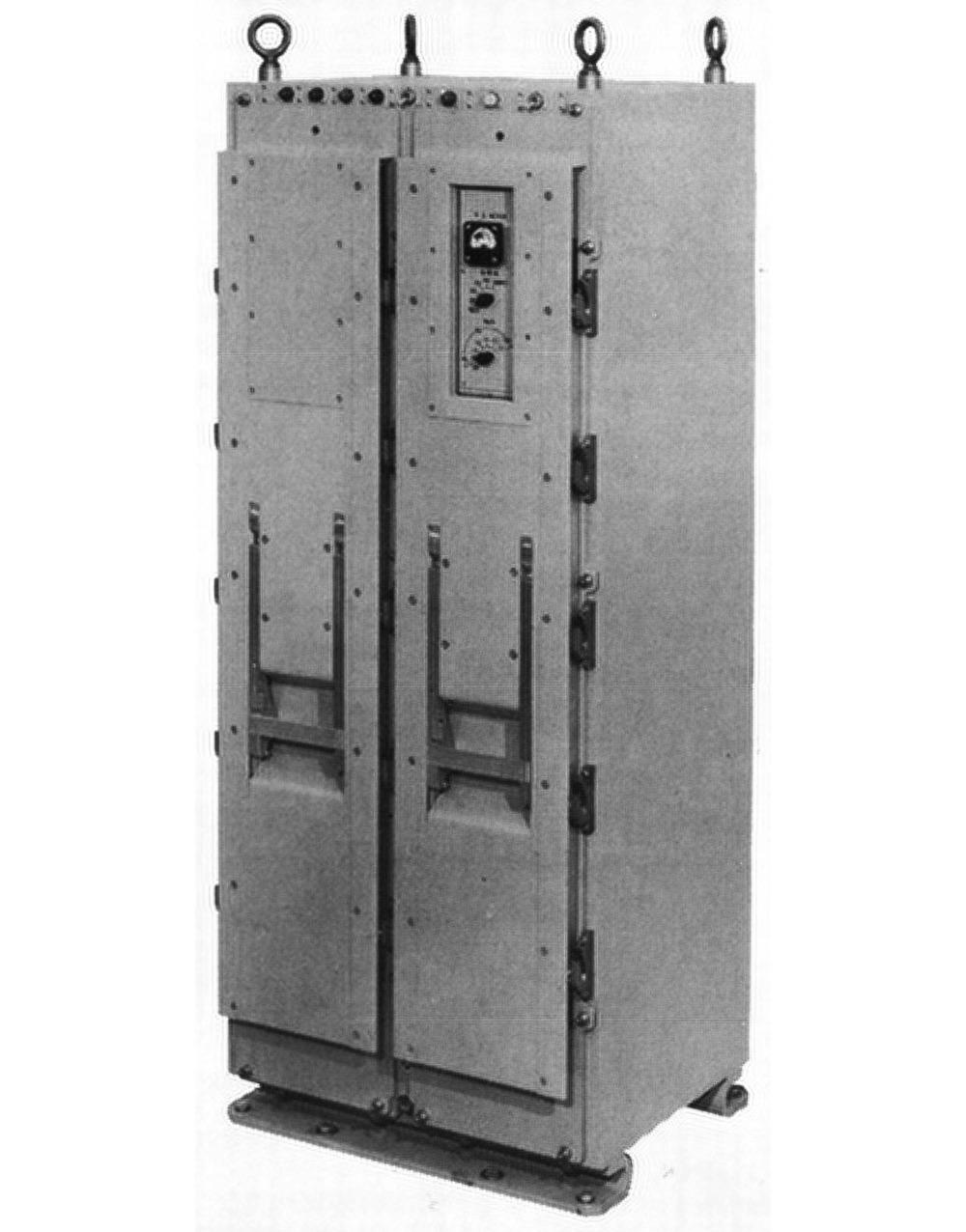

The bulky SP-201 computer was an outlier from the rest of the SP series, since it weighed 660 pounds. Its performance was higher than the other SP models, running 450,000 instructions per second. This computer was part of the sonar system used on Los Angeles and Ohio class submarines. The bow of the submarine contained a giant sphere, 15 feet in diameter, studded with over a thousand transducers to detect underwater sounds. The SP-201 was a "post-classification signal processor"32 in the AN/BQQ-5, analyzing these sonar signals and driving scrolling "waterfall" displays with green lines indicating the presence of ships (or sometimes whales). This computer was carefully designed to be lowered through a submarine's standard 25-inch hatch.
The SP-201 computer, designated CP-1125/BQQ-5. From "IBM System/4 Pi and Advanced System/4 Pi Computers" brochure, August 1973.

Although the AP series was the star of the Advanced System/4 Pi line, massive CC computers ran the Boeing E-3A Sentry AWACS (Airborne Warning and Control System) aircraft. The AWACS is a Boeing 707 with a rotating 30-foot radar dome on top, appearing as if a giant mushroom sprouted from the fuselage. This radar tracked activity over 250 miles away, providing a comprehensive view of the battlefield. Inside the AWACS, the CC was the central mission computer, processing radar data and sending it to 14 display terminals, as well as providing command-and-control functions.
The CC-1 was developed in 1971 as the top performer of the System/4 Pi line at 740,000 operations per second. It supported the System/360 architecture—including System/360 peripherals—but also supported the optimized "CC-1 architecture".33 The CC-1 was followed by the CC-2 (1980), which boosted performance to 2 million instructions per second through the use of Super Schottky TTL.
The CC-2E computer with Memory Enhancement provided four times the main storage and eight times the bulk storage. The CC-2E was massive compared to the rest of the 4 Pi line, weighing 1826 pounds and standing almost 6 feet tall. It ran over 2.7 MIPS (Million Instructions Per Second), over twice the speed of the Space Shuttle's upgraded computer. The computer was redundant to ensure reliability. It also included "nuclear event detection and survivability".
The baseline configuration for the AWACS CC-2E digital computer.
Components are Digital Multiplexer (DMX), Computer Arithmetic Unit (CAU),
Computer Control (CC),
Monolithic Memory Unit (MMU),
and Bubble Memory Unit (BMU).
The baseline configuration for the AWACS CC-2E digital computer. Components are Digital Multiplexer (DMX), Computer Arithmetic Unit (CAU), Computer Control (CC), Monolithic Memory Unit (MMU), and Bubble Memory Unit (BMU). From "AWACS Data Processing Subsystem" brochure, 1991.
The photo above shows the refrigerator-sized cabinet of the CC-2E. The computer is constructed from two types of boards: most of the system used the large MCS pages, while the DMX and Computer Control units used the squat pages of earlier 4 Pi systems.
The CC-2E made use of an unusual technology for mass nonvolatile storage: bubble memory. In the 1970s, bubble memory was the storage technology of the future, providing hard disk capacity at core memory speeds. It used tiny magnetic "bubbles" moving along tracks by magnetic fields. However, improvements in semiconductor memory made bubble memory uncompetitive; by 1981, the New York Times snarkily referred to The Computer Bubble that Burst. Bubble memory was popular with the military because it was insensitive to vibrations, unlike hard disks. Each bubble memory unit (BMU in the photo) in the CC-2E stored 8 megabytes, four times as much as a similarly-sized semiconductor-based monolithic memory unit (MMU). These replaced four rotating magnetic drums in the original CC-1, each storing 400,000 words. To safeguard information from falling into the wrong hands, the bubble memory modules had a "data destruct" feature.
The Computer Arithmetic Unit Assembly, one of two in the AWACS computer. From "AWACS Data Processing Subsystem" brochure, 1991.
The CC-2E had two arithmetic units, each constructed from about 26 MCS pages (above). Each arithmetic unit was a 32-bit computer that implemented 182 fixed-point and floating-point instructions and had an 8K-word cache for performance. It was compatible with the System/360 mainframe and had extensions such as support for arbitrary-length bit fields.
ML-1
Around 1974, IBM introduced the compact ML-1 computer,34 half the width of the AP-101. The technological advance in the ML-1 was LSI (Large Scale Integration) chips, averaging 110 logic gates per chip. (LSI is typically defined as having 100-1000 gates, so these chips are on the very low end of LSI.) Each chip was mounted on a square ceramic substrate, 1 inch on a side, with 48 pins on the underside.35
The IBM ML-1 computer. The core memory stack is visible on the right. From an ad in Air Force Magazine, April 1975.
The ML-1 computer used the same modular core memory as the AP-101, CC-1, and other systems. The ML-1 also supported semiconductor memory, which was volatile (i.e., lost its contents without electricity), but cost "significantly less" than magnetic core memory, was faster, weighed 8 pounds less (for a 32K-word computer), used slightly less power, and reduced the length of the computer by 7 inches.
The IBM ML-1 computer. From "Advanced System/4 Pi Model ML-1 General Purpose Computer" brochure, Dec. 1974.
The ML-1 had a similar architecture to the AP-101, except it used a 16-bit datapath instead of 32. It performed 550,000 operations per second, the same as the AP-101. IBM said that the ML-1 was "adaptable to a wide variety of applications such as guidance and navigation weapons delivery, digital flight control and communications." To support communication applications, the ML-1 had optional byte-handling instructions. The ML-1 was used in a terminal for the Joint Tactical Information Distribution System (JTIDS), as a bus controller in an IBM test facility, and in an airplane landing simulator.
An ML-0 enclosure with the cover removed, showing the boards inside. Photo courtesy of Henry Brandt.
Two years later, IBM designed the less powerful ML-0 (above), briefly mentioned here. This computer was built for the Navy and Air Force's TASES and APMS systems, but the projects were canceled. Rather than the LSI chips of the ML-1, the ML-0 used simpler 5400-series TTL flatpack chips. A ML-0 board (below) is slightly different from the MCS boards in other 4 Pi computers because the ML-0 used air cooling. The back side of the board has machined metal cooling fins; two boards formed a sandwich, linked at the top by two 84-pin connectors, with air blown between the boards across the fins.
An ML-0 interface board, courtesy of Henry Brandt. This is an interface board with flip-flops, multiplexers,
and other TTL chips. The board has different edge connectors from the standard MCS boards and is a slightly different size.
An ML-0 interface board, courtesy of Henry Brandt. This is an interface board with flip-flops, multiplexers, and other TTL chips. The board has different edge connectors from the standard MCS boards and is a slightly different size.

  13. The instruction set used in the AP-101 is called MMP, which stands for Multipurpose Midline Processor. Except IBM's brochure "Advanced System/4 Pi Model ML-1 General Purpose Computer" (1974) says that it stands for "microprogrammed multiprocessor." And the article "A new computer for the Space Shuttle" in IBM's Technical Directions (1986) says that it stands for Medium Multi-Purpose. I believe these are errors.
    The MMP instruction set is very close to the System/360 instruction set at the assembly code level; the instructions are mostly the same with the same mnemonics. Not surprisingly, MMP dropped the business-oriented instructions such as variable-length strings and decimal arithmetic. MMP also provided more advanced addressing modes than the System/360, including indirect addressing.
    However, there are many implementation changes that make the computers completely incompatible at the machine code level. The most surprising change is that MMP does not use bytes at all; a memory address accesses a 16-bit "halfword". In comparison, it was the System/360 that made the byte popular. The registers are incompatible: the System/360 has 16 general-purpose 32-bit registers, while MMP has two sets of eight registers. Moreover, the System/360 uses 24-bit addresses, supporting 16 megabytes of memory. MMP uses 16-bit addresses, extended to 19 bits through bank selection, supporting just 512K halfwords.
    A comparison of System/360 and MMP instruction formats for register-to-register instructions.
    The diagram above shows how the System/360 and MMP encoded instructions in completely different ways. Both systems use an "RR" instruction format, for example, to add two registers. But the 16-bit instructions are encoded with a completely different structure. In particular, MMP uses three bits instead of four to specify a register, along with a shortened opcode field.
    Because of the similar instruction sets, it was very easy for a System/360 assembly-language programmer to start programming the AP series. However, due to the incompatibilities, MMP programs could not run directly on a System/360 but needed to execute through a functional simulator program. In contrast, the earlier System/4 Pi EP was compatible with System/360, so programs could run directly on either machine.
  14. The drawing below shows an exploded view of the Space Shuttle AP-101B CPU (i.e., the earlier version). Half the box is occupied by large storage pages. The logic is implemented with the standard squat System/4 Pi pages, with the power supply underneath. The round connectors on the front are connected to pages through flexible polyimide printed circuits, an impressive technology for the 1970s. The function of each page is described in Space Shuttle Advanced System/4 Pi Model AP-101 Central Processor Unit, page 131 (6-11).
    Space Shuttle CPU—Exploded View. (Click for a larger version.) From Space Shuttle Systems Handbook.

  23. The formation of the AP-101S is also described in AP-101S with Shuttle Instruction Set, section 4. "The elements utilized from the AP-101F are the CPU, MMU (Memory Management Unit), and Interrupt sections. The microcode has been modified so that existing shuttle software can be used on the AP-101S. The Timing page, SDI (Software Development Interface) page and the SIB bus have been eliminated. The unused circuitry in the MMU has been removed to permit integration of the timing and SDI functions into the MMU. The IOP has been repackaged using medium scale integration to reduce the number of pages from fourteen to seven." A more detailed diagram of the AP-101S evolution is in The new AP101S general-purpose computer (GPC) for the space shuttle. Curiously, that source claims the memory in the AP-101S came from the AP-101F, not the AP-102. This source also explains the AP-101S/G, an interim version that was used on the ground during development. The AP-101S/G was essentially the AP-101S with the Shuttle's IOP (I/O Processor) as a separate box.
    Did the Shuttle's AP-101S support the Air Force's standard 1705A instruction set as well as the MMP instruction set? Sources are contradictory. The B-1B's AP-101F supported both instruction sets and the AP-101S inherited this architecture: "The AP-101S central processor unit is optimized for both MMP and MIL=-STD-1750A" (source). According to The new AP101S general-purpose computer (GPC) for the Space Shuttle, the internal controls and microcode of the AP-101S support both architectures and the AP-101S could readily be configured for either architecture by a control signal on the interface. The obscure AP-101SG/1750 ground computer is said to have run 1750A. Other sources say that the AP-101S did not support 1750. My interpretation is that although the hardware for the AP-101S supported both instruction sets, the flight version of the AP-101S did not have the microcode for 1750A, due to the limited microcode space.
  24. Spacelab originally used CIMSA 125 MS computers. The naming of this computer is very confusing. Starting in 1971, a French company called CII produced a popular line of 16-bit minicomputers called Mitra 15. In 1975, CII produced a successor called the Mitra 125. In the mid-1970s, CII and Honeywell merged and the computer division was spun off to form SEMS, with majority shareholder Thomson. Thomson's subsidiary CIMSA produced the computer for Spacelab, the 125 MS computer, part of the CIMSA militarized 15 M computer line. This computer was functionally identical to the Mitra 125 S that the Spacelab project used on the ground (details). Meanwhile, MATRA (different from Mitra) was the contractor for Spacelab command and data management. To summarize, Spacelab used CIMSA 125 MS computers, as can be verified from the label below. This is a militarized version of the Mitra 125, produced under contract from MATRA. People sometimes call this computer the MATRA 125, but that's an error.
    CIMSA 125 MS computer. Click this photo (or any other) for a larger version. Photo by Steve Jurvetson, CC BY 2.0.

  26. The AP-101S had a Memory Management Unit (MMU), implemented on two pages. In most computers, a Memory Management Unit implements virtual memory by translating virtual addresses to physical addresses, but the MMU in the AP-101S is not as advanced: its MMU enlarged the memory address space through bank switching.
    The AP-101 line of computers originally used 16-bit addresses that accessed 16-bit halfwords (not bytes), so they could directly access 64K halfwords (equivalent to 128 KB). This wasn't enough address space for constantly-growing software, so the AP-101B used a bank-switching technique that allowed access to 512K halfwords, albeit in 32K chunks. (The AP-101B could not hold this much memory internally, but external memory boxes could be added.) Specifically, the Processor Status Word held a 4-bit bank select field for code access and another 4-bit bank select field for data access. These fields could be substituted for the top bit, enlarging the address space from 16 bits to 19 bits. The AP-101S extended this approach with a complicated scheme of "Expanded Addressing". In this approach, each index register had a separate 4-bit bank select field. This allowed multiple banks of 32K to be used at the same time.
    The main purpose of the Memory Management Unit was to convert a 16-bit memory address to a 19-bit physical memory address by substituting the appropriate bank select bits. The MMU also detected and handled memory faults. Finally, the MMU included seemingly random functions such as the processor's 40 MHz system clock.
    (Don't confuse the MMU (Memory Management Unit) in the computer with the MMU (Mass Memory Unit), one of two tape drives on the Shuttle; the MMU (Manned Maneuvering Unit), a propulsion backpack for spacewalks; or the MMU (Monolithic Memory Unit), the CC-2E's semiconductor memory.)
  27. From front to back, the boards in the AP-101SL are: A4, A5, A6 (CPU3), A7 (CPU2), A8 (CPU1), A9 (interrupt), A10, A11, A12 (RAM), A13 (RAM), A14 (12V power supply), and A15 (5V power supply). A10 contains the 40 MHz oscillator, which was on the MMU2 board in the AP-101S. Perhaps A10 and A11 are the equivalent of the MMU boards, but without the peculiar memory block scheme of the AP-101S. A4 may be a digital I/O board. A5 has optoisolators and analog components, so it is presumably an I/O board. The power supplies and memory boards look identical between the Shuttle's AP-101S and Spacelab's AP-101SL. The CPU and interrupt pages are very similar, perhaps just bug fixes during development. The exception is that one side of the CPU3 page is substantially different. (The boards in the AP-101S are listed in AP-101S with Shuttle instruction set page 18, so I won't repeat the list here.)

  30. The Space Shuttle display screens are heavy on text, but include vector graphics, advanced for the time. The display below shows the Shuttle coming in for landing. The small circles predict the Shuttle's location in 20, 40, and 60 seconds. The large circle indicates the runway.
    The Horizontal Situation Display. From New Displays for the Space Shuttle Cockpit.
    The Space Shuttle's displays are described by a jumble of acronyms. A CRT screen was a Display Unit (DU), part of the Multifunction CRT Display System (MCDS). The screen was controlled by a Display Electronic Unit (DEU), which contained the SP-0 processor. The SP-0 created Format Control Words (FCWs) in memory that controlled the characters and vectors on the display. In 2000, the MCDS was upgraded to eleven color LCD screens (MEDS). For details, see Space Shuttle Avionics Upgrade: Issues and Opportunities, Entry, TAEM, and Approach/Landing Guidance Workbook, Space Shuttle Flight Software, Space Shuttle Avionics Systems, and The Space Shuttle Orbiter's Advanced Display Designs and an Analysis of its Growth Capabilities

    The Advanced Signal Processor (AN/UYS-1 "Proteus") was a large, cabinet-sized system that processed sonar signals in numerous Navy aircraft, ships, and submarines. It has up to four arithmetic elements with a pipelined multiplier and adder, as well as a sine-cosine generator for FFTs (fast Fourier transforms), allowing it to perform up to 60 million operations per second. More details on the ASP are here.
    The ASP array processor led to the development of the IBM 3838 Array Processor. The IBM 3838 was connected to a mainframe and provided vector operations such as add, multiply, FFT, trigonometry, and polynomials. It had the codename "Gusher" since it was originally intended for seismic analysis for the petroleum industry, but it could also be used for applications from weather modeling to plasma computation.

The shuttle displays always intrigued me. I've seen photos of the screens on the payload console on the back of the cockpit, but never found any good documentation.
The exact vector shapes of the fonts seem to have been lost to time.
I never got a good answer to https://space.stackexchange.com/questions/41048/are-there-any-close-up-photos-of-the-screens-used-in-the-mocr2-from-the-apollo-e as well.
I would love to be able to see those fonts and remake them as TTFs

Ricardo: The vector font was generated by the DEU box, but I haven't seen any information on the font specifically. Robert: I don't know what they mean by an IBM/360 typeface, since the typeface depended on what peripherals you attached to a System/360.
