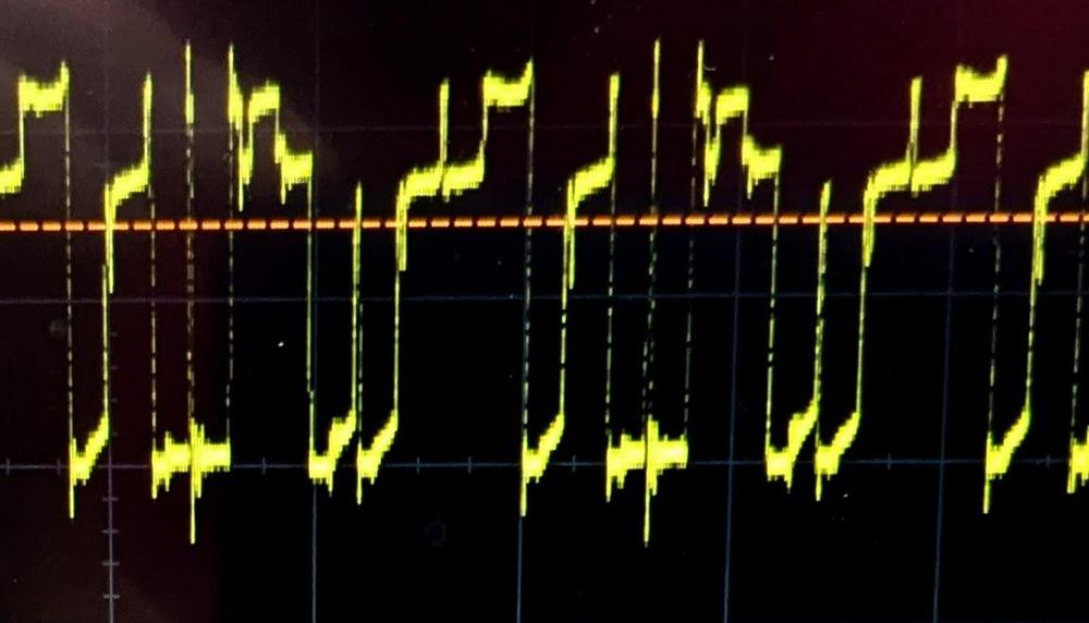

With an oscilloscope, I examined signals on the system bus and found that the clock, address, and data lines were full of activity, so the 6502 CPU seemed to be operating. However, some of the data lines had three voltage levels, as shown below. This was clearly not good, and suggested that a chip on the bus was messing up the data signals.
The scope shows three voltage levels on the data bus.
Some helpful sites online7 suggested that if a PET gets stuck before clearing the screen, the most likely cause is a failure of a system ROM chip. Fortunately, Marc has a Retro Chip Tester, a cool device designed to test vintage ICs: not just 7400-series logic, but vintage RAMs and ROMs. Moreover, the tester knows the correct ROM contents for a ton of old computers, so it can tell if a PET ROM has the right contents.
The Retro Chip Tester showed that two of the PET's seven ROM chips had failed. These chips are MOS Technologies MPS6540, a 2K×8 ROM with a weird design that is incompatible with standard ROMs. Fortunately, several people make adapter boards that let you substitute a standard 2716 EPROM, so I ordered two adapter boards, assembled them, and Marc programmed the 2716 EPROMs from online data files. The 2716 EPROM requires a bit more voltage to program than Marc's programmer supported, but the chips seemed to have the right contents (foreshadowing).
